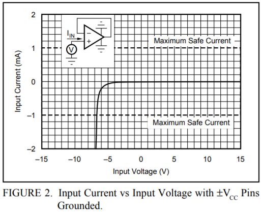

Hi All, can you please let me know the input clamp diode ratings for the part OPA111AM?  The diode from either input to the supplies or suppose the inputs exceed the supplies by 0.3v in that case what will be the current conducted through the clamp diodes ?

  • thanks for the reply, i read the input protection section and from there i felt that the datasheet specifies that a 10K resistor should be used in case the +/-15v supplies are lost from which i tend to conclude that the input pin current should be limited to 1.5ma?
    Also what is the limit to which the inputs can go beyond the supplies for this opamp ?

    The OPA111 is a legacy op amp. My search for the internal schematic indicates that it was introduced about 35 year ago. The schematic does not show the any ESD cells in the design. That is not unusual for a precision op amp from that era. Thus, it does not have any clamps from the inputs to the internal supply rails.
    The Absolute Maximum Ratings table lists the Input Voltage Range (note 2) .... ±18VDC. Note 2 - For supply voltages less than ±18VDC, the absolute maximum input voltage is equal to +18V > VIN > –VCC – 6V. See Figure 2. Here is Figure 2 from the datasheet:
    The figure indicates the maximum safe input current is +/-1 mA for the conditions shown. I suggest not exceeding the Input Voltage Range limits in the Absolute Maximum Ratings table if you want to avoid damaging the amplifier.
    Regards, Thomas
