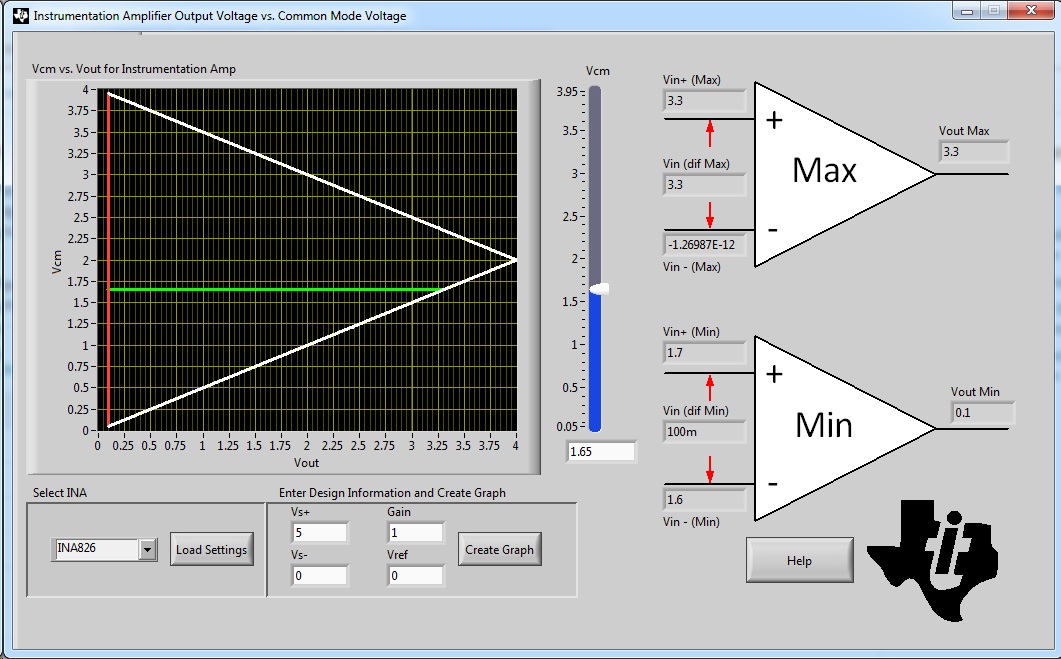

I have this plot for my target application:
I want a dynamic range as close to 0-3.3V as I can get so I'm looking at biasing this part at a higher voltage.  The Vcm will usually be 1.65V.  The Vref can change since it is user settable.  I noticed that if the Vref is set to 0V the "Vin (dif Min)" value is 100m.  I assume this is 100mV.  My question is, what exactly does this mean?  What happens if my Vin differential voltage in this configuration is lower than 100mV?  Say I set this up and put a 10mV or 1mV differential signal on the input?  What happens?  I thought these devices were designed to receive very small voltages.
The output max and min means the output won't exceed those values, but the input can theoretically be driven with anything so what exactly does that mean?  What happens if I violate it?
What do you do if you want to sense a smaller differential voltage?

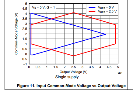

    Additionally, have a look at figure 11 of datasheet:
    For you the blue curve is valid. This curve also shows that the output voltage cannot go below 0.1V. If you need to produce an output voltage below 0.1V you would need to use a dual supply voltage. But, alternatively, you could set the reference voltage to a higher voltage, 2.5V e.g.. Then your output signal can swing arround 2.5V.

  • what does Vin(diff) mean? What happens when you input a smaller differential voltage than what the tool says?
  • Hi Robbie,
    Vin(diff) is the differential voltage applied between the inputs of the instrumentation amplifier. The minimum differential voltage you can apply is based on the output limitations and is related through the gain. Since the output can't swing lower than 100mV away from the rail, you can't apply a signal on the input that would attempt to force the output lower than that and expect a linear output. The output amplifier will saturate at the rail and you will see a constant 100mV signal at the output as you decrease the input. If you were running in a gain of 10, then the calculator would tell you that the minimum differential input is 10mV.
