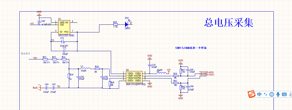

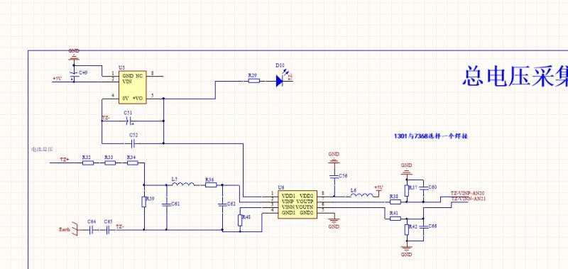

Hi

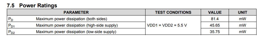

the AMC1301 power dissipation as datasheet, but in my application,I used 5V power supply but the current has 50ma
It seems too high than datasheet. My schematic as follows,I used digital multimeter for meeasuring current.
I has a 150ma LDO to power 5 AMC1301,it 's can not work,so I guess the AMC1301 power dissipation too high.
please help!
