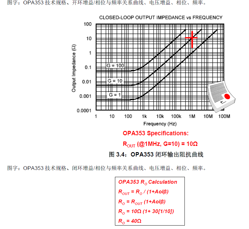

Hi team,
I read the Operational Amplifier Stability Document that is written by Tim Green.
When I note ROUT= RO/ (1+Aolβ). Then Tim Green gives an example with OPA353.
Please check the attach.
In the formula, 1/β= the closed loop gain. But 1/β=Vout/VFB.
I would like to verify if I can use 1/β= the closed loop gain when I analysis the operational amplifier stability?
Or when I can use use 1/β= the closed loop gain to analysis the operational amplifier stability , when I cannot use use 1/β= the closed loop gain to analysis the operational amplifier stability.
