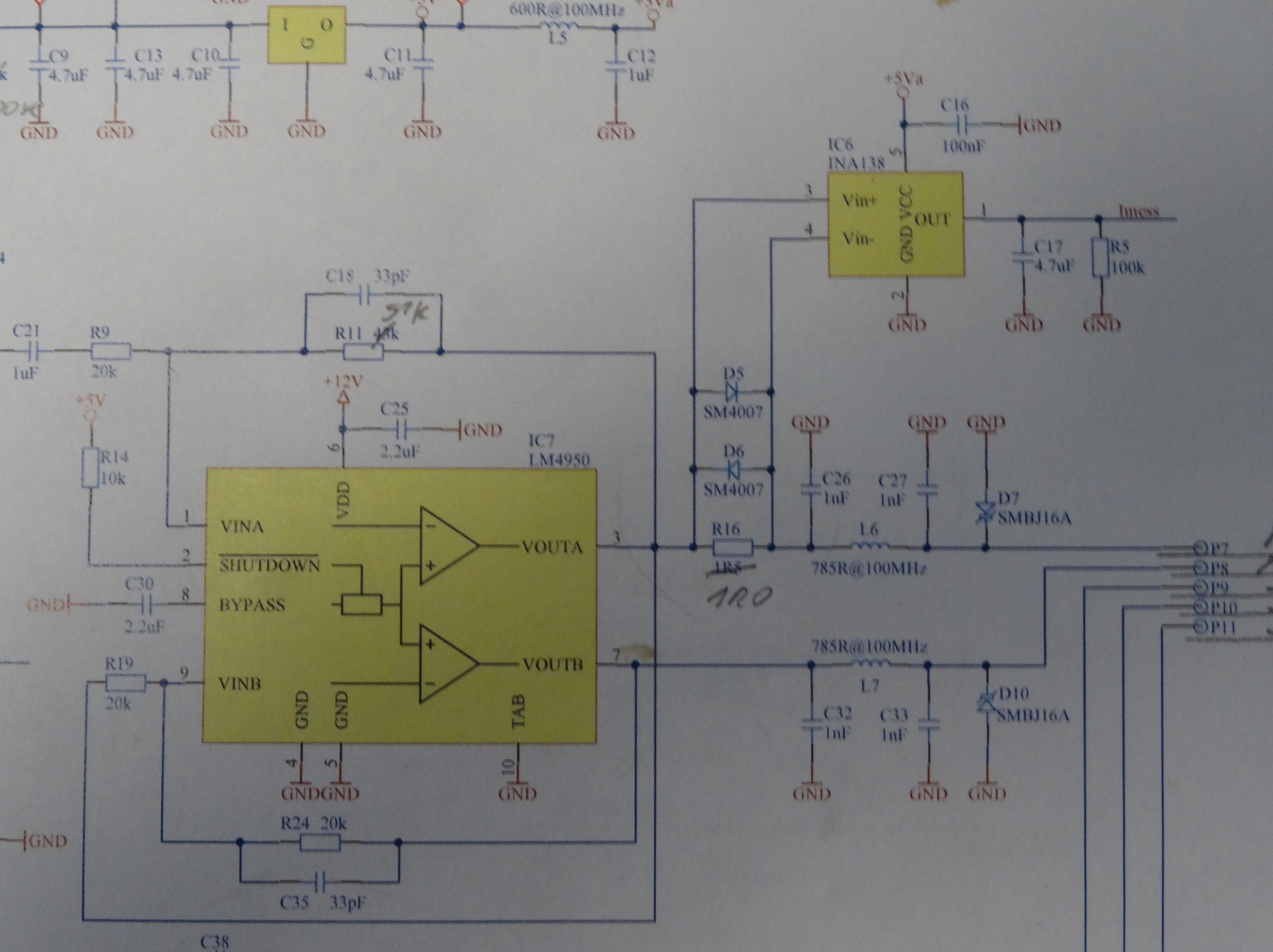

Hallo,
I'm using the INA138 (IC6) to measure the Output current of a Audio amplifier (LM4950). Current is sinusoidal with a Amplitude of 100mA, wich produces on shunt R16 a  sinusoidal voltage of 100mV.
The measurement works fine, but there is a great temperaturdrift of Output-Signal Imess. If temperature of INA138 rises about 20K,  drift of Imess  is more then -15% ???.
Common Mode voltage at INA (Vin+ ans Vin-) is more then 3V.
Has anyone encountered  the same Problem ?
