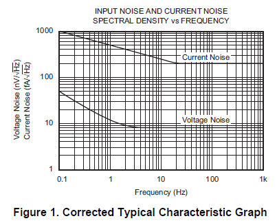

I'm having a 10Hz system using the the OPA277 amp.
I the ds the voltage noise is specifyed as:
Input Voltage Noise, f = 0.1 to 10Hz 0.22uV PP and 0.035u Vrms
If i look at the "INPUT NOISE AND CURRENT NOISE SPECTRAL DENSITY vs FREQUENCY" the noise up to 10Hz is dominated by the 1/f and the graph shows the noise density @1Hz ~ 50nV
I'm for 1/f noise learned to  use the equation en1/f = (e1/f@1Hz)([ln(fH/fL)])   use fH = 10Hz; f L= 0.1Hz
en1/f  = (50nV)(√[ln(10Hz/0.1Hz)]) = 107nVrms
....which is much larger than the 0.035nVrms given in the ds?
Where do i go wrong?
Many thanks
/Mattias

    You are correct that there is an inconsistency in the OPA277 data sheet.  I also think the problem is that the frequency axis of input voltage noise graph is mislabeled.  Art Kay looked into this issue some time ago and that was his conclusion (please see the attached presentation).

  • Mattias,
    There was an error in the original PDS noise graph where the horizontal axis were mislabeled by a decade (1Hz to 10kHz instead of 0.1Hz to 1kHz) - see below. There is an errata sheet next to PDS (see attached) pointing the error.  The final result is that the actual voltage noise spectral density should have been 50nV/rt-Hz at 0.1Hz instead of 1Hz as originally shown in PDS.  Taking this into account, you may calculate the noise for 1Hz using following equation:
    e1/f@1Hz = (e1/f@f)([f]) = 15.8nV
    Using 15.8nV value instead 50nV at1Hz in the Input Voltage Noise, f = 0.1 to 10Hz, equation:
    en1/f = (e1/f@1Hz)([ln(fH/fL)]),
    will result in 0.035uVrms value correctly specified in PDS.
