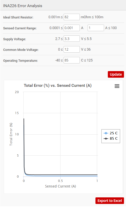

    Thanks for your interest in current shunt monitors.  Since your max current value is 1000x larger than your min current value, you will want to use the entire allowable shunt voltage range of 81.92mV to mitigate the error sources that can effect the accuracy of low value measurements.  We assume that this voltage will be generated when the max current (1A) is across your shunt.  Consequently, I would use a 82 mohm shunt or slightly smaller to account for resistor tolerance.  With that shunt we can get an idea of what kind of error you would expect over your range of measurements using the online calculator (shown below) that can be found on the right side of the INA226 product page.
    Alternative parts that you might consider are the INA220 and INA219.  However, these will have lower accuracy at the lower part of your measurement range.
