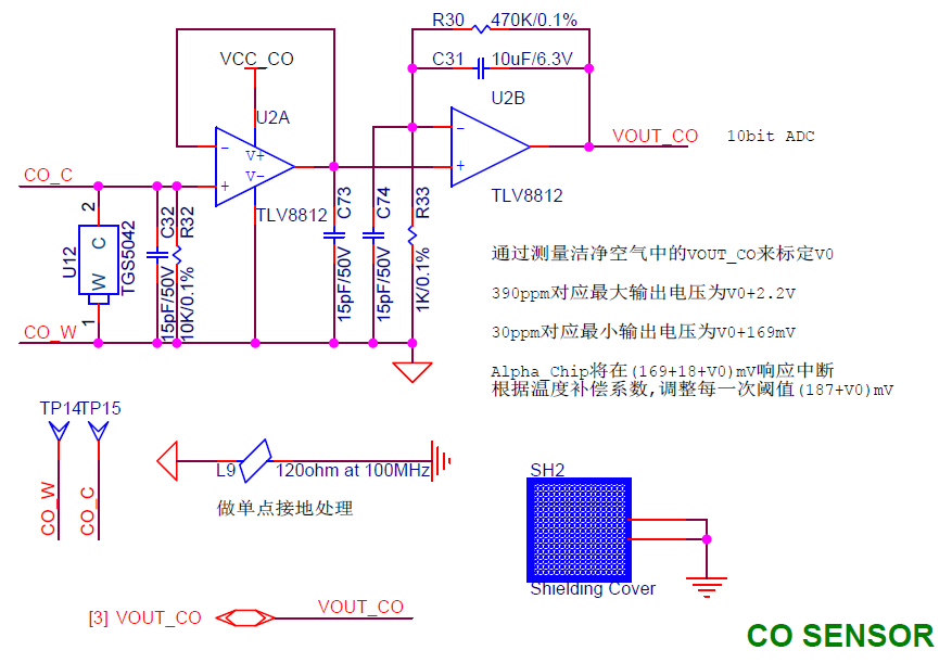

I'm using TLV8812. Please kindly help to review the schematic as blow, any comment will be appreciated. Thanks very much.

This looks fundamentally good. I would probably add a resistor between the feedback node and C73 for amp 2a. This way you can create a low pass RC filter. Before gaining up he signal additionally in stage 2. I would also include an anti alias filter (RC) filter before driving your ADC. This is just good practice for ADCs.
Chuck
That looks good. You may want to increase the size of c73 and decrease c75 to optimize filtering. But this is something you can optimize in your prototype phase since you have the footprint in your circuit.
Chuck
