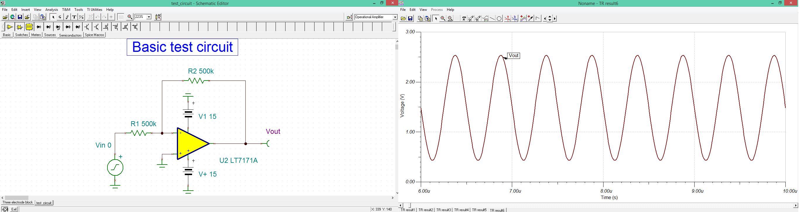

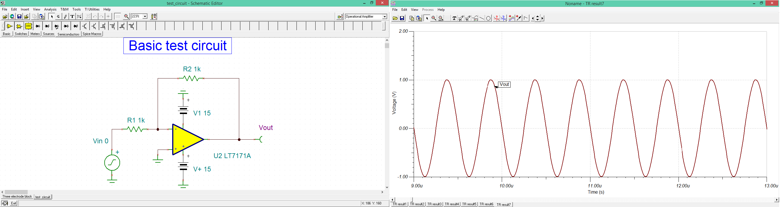

Hi, i have simulated LM7171 for low and high resistor values for the same gain. For low resistance values, the simulation results are fine. However i have observed a DC shift of about 1.5V at output when i use high resistance values for same gain compared to low resistance values. It is a design requirement so i have to use high resistors in my design even for smaller gains. I have excited the circuit with 2Vpp at 2Meg in both cases. Please suggest way to remove DC offset.

    you have forgotten that the LM7171 has an input bias current of about 3µA. 3µA x 500k = 1.5V. :-)
    The LM7171 is a HF OPAmp and should be used in combination with small feedback resistors, especially to make the circuit immune to the impact of stray capacitance. See also figure 54 of datasheet.
