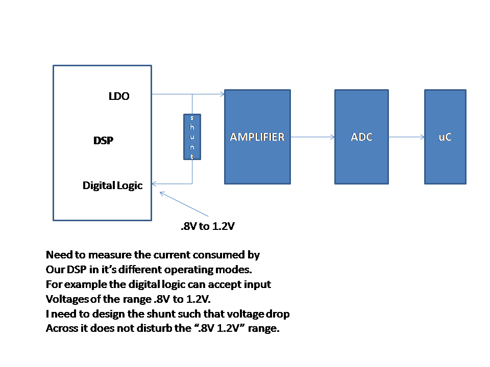

  •  Hi Kai,
    I am attaching the initial block diagram along with this mail
    Shunt resistor is not calculated yet.
    if you don't mind please go through this block diagram.
    Expecting your valuable suggestions on shunt resistor Design according to the requirement given in the Block diagram
    Hari
  • Hari,
    This is not much of a specification. You have posted in multiple locations with different ranges given for the current you are measuring. Given that you have not selected a shunt, please confirm the range of current that you need to measure and with what resolution. What is the resolution of your ADC and what will be the full scale range of this converter (to determine LSB size)? Based on above I am assuming that you are using a 1.2V LDO. As Kai and Marek have mentioned the dc errors of the INA333 and any other device you could use here are going to dominate your low signal levels and will thus require calibration. You may be better of using a zero-drift op amp configured as a difference amp to at least avoid the need for a temperature calibration.
  • Hi Zak,
    We are in a design phase final values are not decided yet. Most probably current is from 1uA to 100ma.
    Hari
  • Hi Hari,
    Please understand that without having a defined system it is very difficult for us to make recommendations. Generally, you will choose the uC and the ADC first and then design the front end amplifier. You will need to switch in different shunt resistors to maintain reasonable accuracy across the entire range. The values you should use depend on your system specifications, such as how much resolution you need, what kind of SNR you are targeting, the full scale input range of your converter, etc. You will need to use switches that have very low leakage and low on resistance to ensure the switches do not significantly impact your measurement. Relays are ideal, but you may be able to find a FET that will be suitable and can be driven from a GPIO pin on your micro once the ADC registers that a measurement is out of range.
  • Hi Zak,
    Sorry for troubling you and your team without proper spec.
    We have almost finalized our specifications.
    Minimum current to be measured=.2mA
    Maximum Current to be measured=100mA
    Rsense=.1Ohm
    Minimum Current Step=0.01mA
    I think now I can manage with single resistor
    Hari
