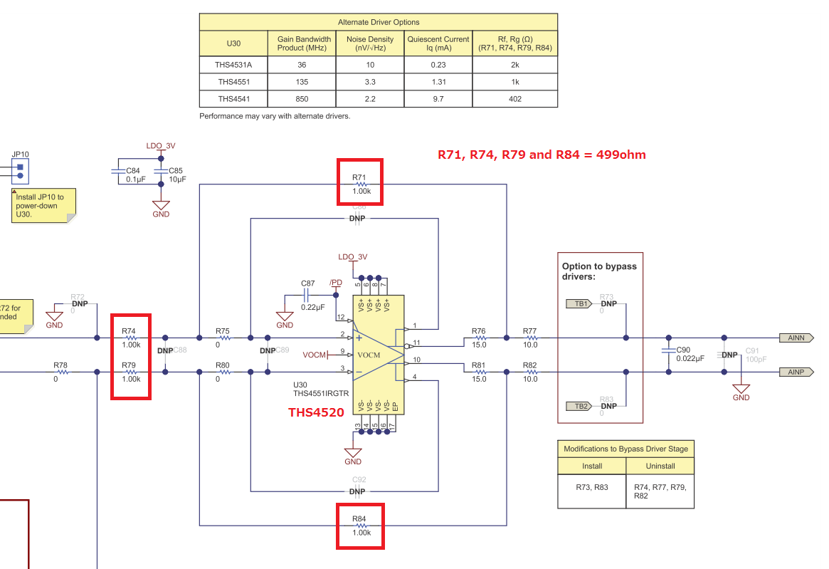

I am concerned about whether THS4520 will work stably since it is different with the schematic which is mentioned in THS4520 data sheet.
So, could you please tell me the recommended value for each resistor and capacitor if setting the 0dB gain with THS4520 such as the following schematic ?
* THS4520 is used as the ADC driver for ADS127L01.

  • Hi Kato-san,
    Replacing the THS4551 with THS4520 for the existing schematic as shown in Figure 122 of the ADS127L01 datasheet should work without any issues. The THS4520 being a voltage feedback amplifier should have minimal dependency to the feedback resistor (RF) of 1.2k.
    Rohit

    By the way, could you please tell me whether THS4520 would also work without any issue at the following schematic ?
    Kato
  • Hi Kato-san,
    Yes. I think you should be able to use the attached THS4520 schematic while driving the 0.022 uF capacitor. Only thing is that you will not be able to get the filter attenuation at high frequency, which you would otherwise get with the Figure 122 of the ADS127L01 datasheet.
    Rohit
