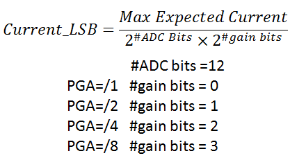

Hello, I have not used the INA219 or have done any current sensing in my past designs. I'm having a little trouble calculating the value of the Rshunt resistor. Let me run my numbers by anyone in the forum and see if I'm lost of on the right path.
Maximum Expected Load Current: 2.45A
Nominal load current = 1.225A
Full Scale voltage setting 40mV
Rshunt = Max Expected Load Current / Full Scale Voltage =  40mV/2.45A = 16.3mOhms
Vshunt = 1.225A*16.3mOhm = 20mV
Common mode voltage is 0.85V.
Voltage at IN- = (0.85 - 0.01996) = 0.83V
Resolution = 2.45A / 2^15 = 74uA/Bit
Does this sound reasonable or am I way off?
