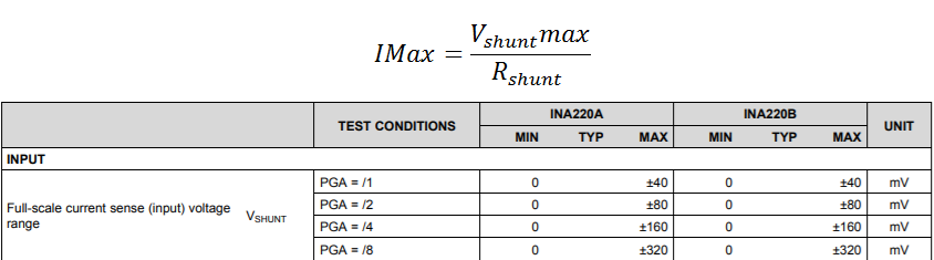

Part Number: INA220
What is the maximum current that INA220 can support the measurement?

Hello Randy,
Thanks for reaching out on the forum. As kai said, the shunt will determine the max current you can measure. However, if the current is really high, then a lot of power will be dissipated across the shunt. At the point you may want to consider a fluxgate sensor, hall sensor, or an isolated amplifier.
