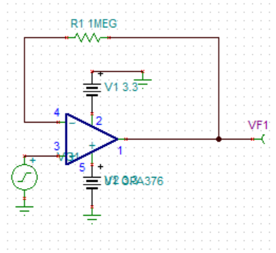

TINA/Spice/OPA376: noise model of OPA376 inside TINA
Part Number: OPA376
Other Parts Discussed in Thread: TINA-TI,
Tool/software: TINA-TI or Spice Models
this is the simulation circuit.

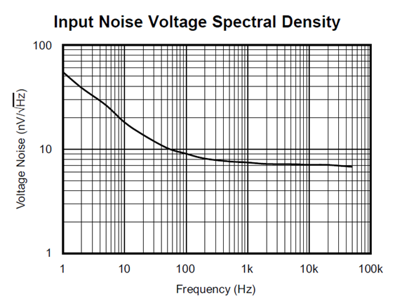

when R1=1k, the result is :
the same with curve in datasheet:
but when R1=1M, it seems like that:
why and is it in line with reality?
thanks!
  • Hi Yuan,
    the reason for the peak is very simple: WIth the 1M feedback resistor the OPAmp becomes unstable and shows a huge peak in the frequency response, exactly where your noise peak is located.
    The 1M feedback resistor in combination with the input capacitance of OPA376 produces a heavy phase lag in the feedback loop which totally erodes the noise margin. That's the cause of instability and noise peak.
    Kai
