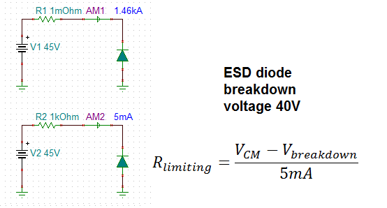

1)  What could lead to this kind of behavior? (  in some conditions I may have some small inductive pulses higher than specified VCM, for a very short time)
2)  What is the maximum accepted current in case of VCM achieved .. 10R to 50R is enough to limit the clamping current?

    1. From what you have said about externally injecting a voltage on VIN+ and VIN-, you probably have destroyed the part as the 30mA is substantially higher than the typical input bias current of the part over the entire common mode voltage range. I think if you perform the same test with a fresh part you can confirm this.
    While the internal ESD structures are designed to protect the device from ESD events that inject large voltages onto the device, these events are of extremely short duration. Your inductive transients although short to you, may still be an order of magnitude longer than a typical ESD event and as such may allow for the ESD to sufficiently heat up and experience thermal damage.
    2. If you want to limit the current solely with a series resistor to your input pin, you will need a fairly large one depending on how far above the rated common mode voltage you plan on going. Below I give a simple example. The top shows what current will be sunk assuming there is only board trace resistance, while the bottom example shows how to sink only 5mA given max transient VCM is 45V.

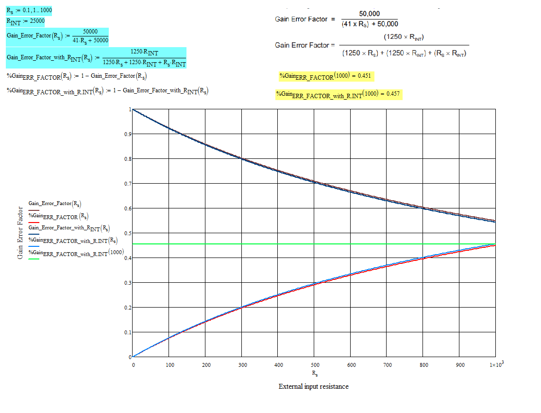

    2, 3 and 4) I would use 1K as in inductive load enhancement, I don't have time to introduce INA240, I have design freeze in 1Week. The problem here is how controllable is the gain error factor in function of input resistance ( see my draft evaluation from attachment assuming an input resistance from 0.1 to 1000 ohm). May I use my calculation a an gain error factor compensation? EG: if using 1k that the ADC_CURRENT maiybe compensated with  aan correction factor of  Iout*(1+0.451) ? How accurate may be that... ? How stable/ Controllable is the input resistance  RINT ?

    These Rint impedance is 40k with a tolerance of 15%. So your gain error may range from 45.1% to 45.3% and you should be able to calculate this using the formulas you posted above.  As you intend to compensate in your ADC reading and account for the change in gain, you should be ok.  However, do not forget that there are other sources of error.  Most of the other sources will only matter for low currents though.  If you are unfamiliar with error from CMRR, PSRR, and offset, I would recommend looking at the following training series here.
