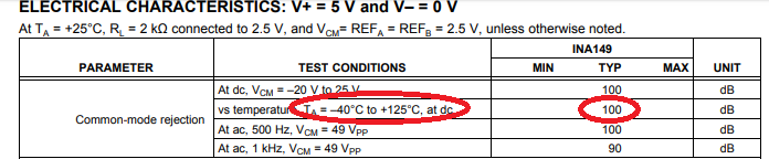

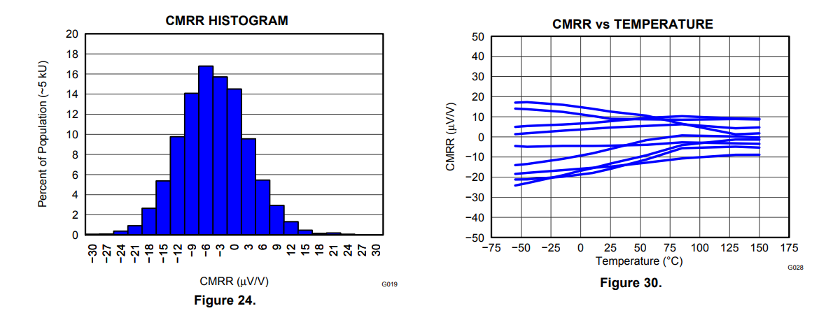

  • Kato,
    Since CMRR in the difference amplifier is determined by the resistor matching, which is trimmed in INA149, there is no difference in CMRR distribution between the wafer lots.  The actual CMRR distribution as well as typical variation of CMRR with temperature is already included in the datasheet - see below:

  • Hi Marek-san,
    Today, I discussed this topic with our customer, so I will need to provide the more detailed information as he cannot estimate the average value and standard deviation from figure 30.
    I have already sent a friend request to you, then could you please provide the raw data of more than 100 samples for "CMRR vs TEMPERATURE " such as figure 30 via a private message on e2e ?
    If impossible, could you please provide the distribution data of average value and standard deviation after the statistical processing instead of the raw data ?
    Kato

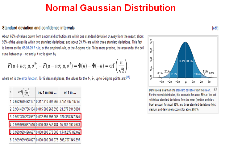

  • Kato,
    We do not have raw data of INA149 CMRR vs Temperature distribution of 100 parts to share with customer and that is the reason why INA149 specification shows only typical 100dB (10uV/V) value - see below.  But since our typical value represent mean+one standard deviation, with a mean being around zero, this means that sigma of CMRR over temp is approximetely 10uV/V.
    What this means is:
    99.7% of all units will have CMRR over temp within +/-30uV/V limit (+/-3 sigma)
    99.99% of all units will have CMRR over temp within +/-40uV/V limit (+/-4 sigma)
    99.9999% of all units will have CMRR over temp within +/-50uV/V limit (+/-5 sigma)
    Please see Normal Gaussian statistics below:

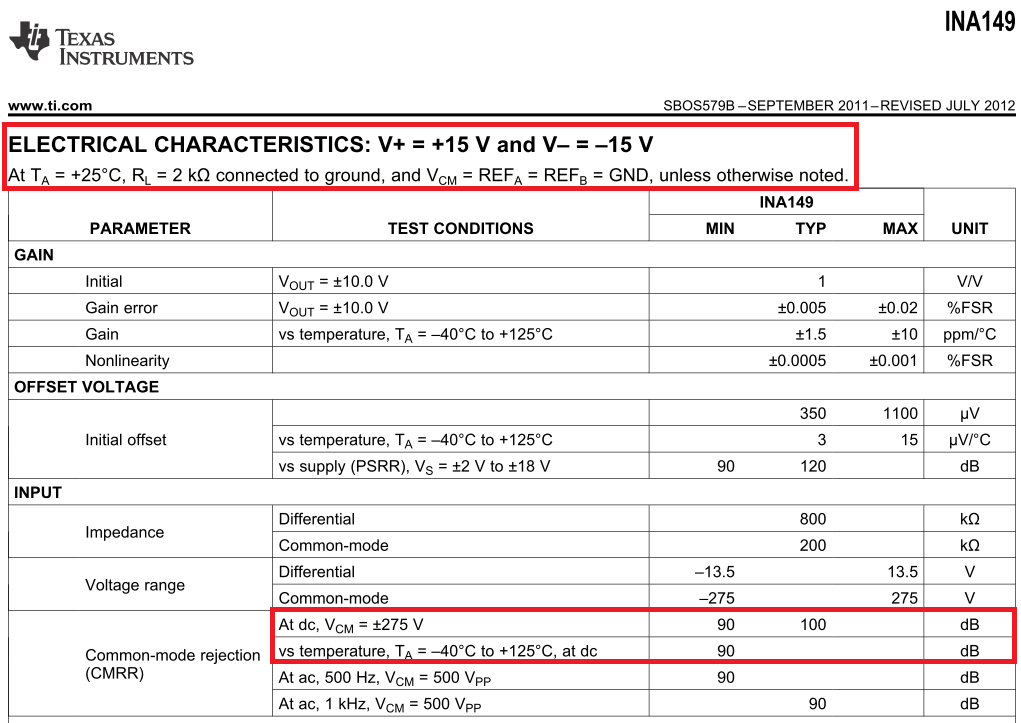

  • Hi Marek-san,
    Thank you for your continuous support.
    For CMRR, the minimum value is defined in the following condition, so I am convinced that its distribution data exists.
    In addition, could you please provide the raw data shown in figure 30 since our customer is considering to grasp the distribution data based on the measured data ?

  • Kato,
    I have located some original CMRR over temperature characterization data for INA149 but cannot post it on this external forum.
    Please contact local TI FAE, Taketo Sato <taketo@ti.com>, to forward it to you.
