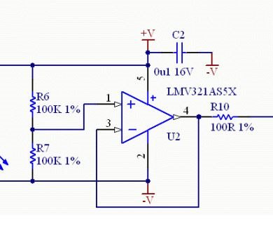

Virtual ground split supply circuit-Stability
Please find the attached virtual ground split supply circuit.
In the output, you can see the Resistor R10 of 100ohm the designer says it is for stability.
May I know how this resistor determines the stability

  • Hari,
    If you drive a capacitive load,  an open-loop output impedance, Ro, forms a pole with Cload which depending on the size of the CL may lead to instability.  Whereas any additional impedance inside the closed-loop makes things worse from stability point of view, adding a resistor, Riso, in series with the output outside of the loop forms a canceling zero in the close-loop transfer function thus improving the phase margin.
    Of course, if you also drive a resistive load, adding Riso resistor will lead to a gain error due to resistive voltage divider.
