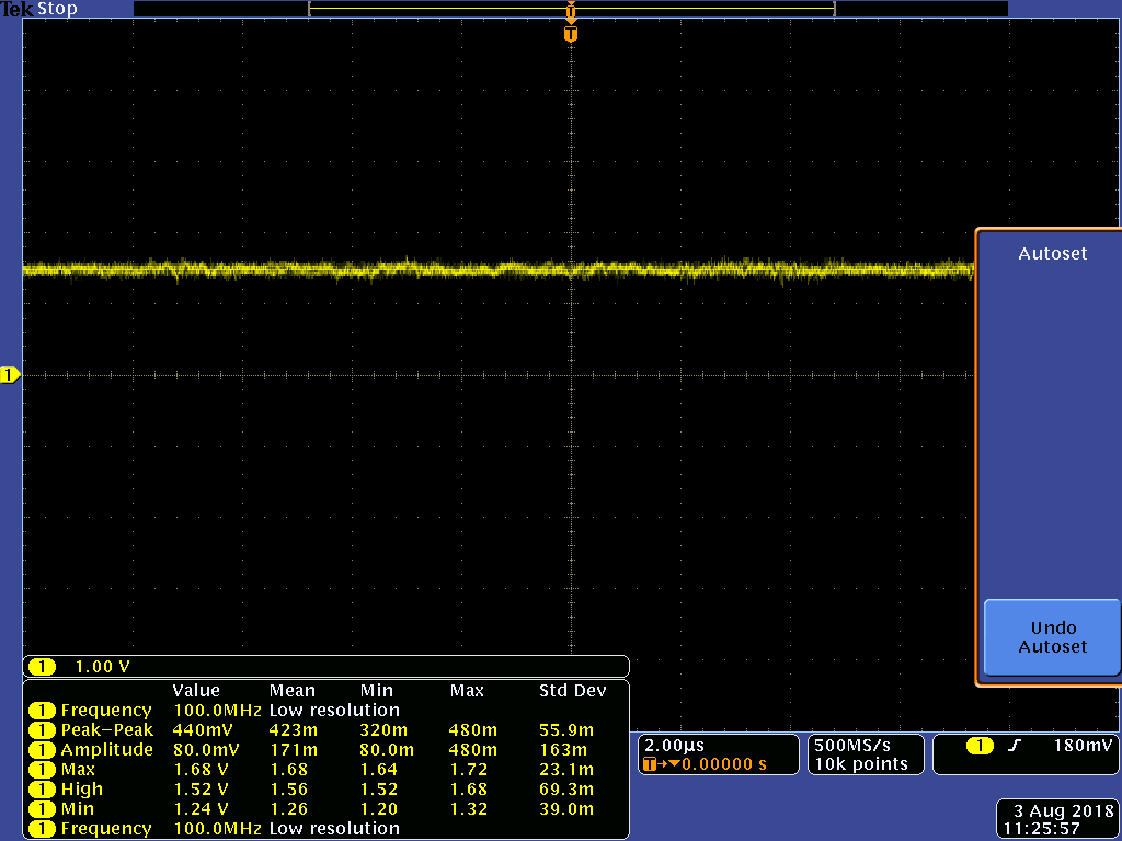

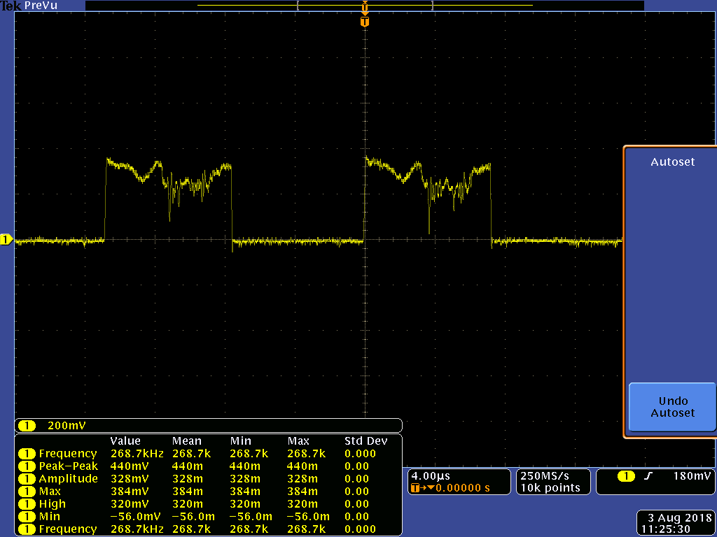

              We are using THS4022ID Op-amp in of my project. Here we are splitting one VGA input to Two VGA outputs ( Using THS4022ID ).
In RED colour input signal swing is upto 384mV. But my output signal just level shift to 1.6Volt, but there is no signal swing in my output side.
Hence my out on display monitor is just blank.
I request you to help me to debug further for solving the above issue.
Hereby attaching my input, output wave form and also my schematic,layout .

  • Hi Lakshmanan,
    the THS4022 needs a minimum gain of 10 to work stable...
    Kai
  • Hi Lakshmanan V,
    Kai is correct, and you are only using a Gain=2. If you look at this amplifier's Aol, or open loop gain, which is the blue line in Figure 5 of the datasheet, you will see that the slope changes from -20dB/decade to -40dB/decade at around 20dB, or a gain of 10V/V. This type of amplifier is called decompensated, or non-unity-gain-stable. You can either Increase R40, R37, etc. to at least 4.5k and the amplifier will start working in a gain of 10V/V, or use a different amplifier that is unity gain stable.
    Sean
