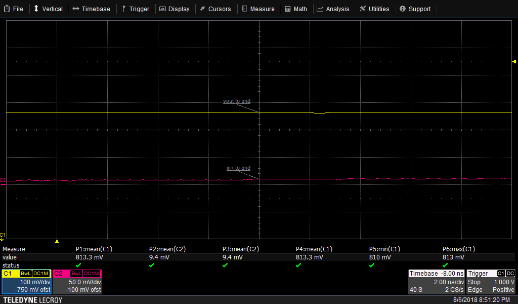

    I am looking into your issue.  I will consult our design team tomorrow to see if there is any condition in which they would expect the input bias to cause the errors you are experiencing.  However at this point I am concerned about the performance of your current device.  I would expect that if your device has REF2=1.225V, REF1=GND, and your VSense= 10mV (max positive peak), then I would expect an output of 1.225V/2+.01V*20V/V = 0.8125V.  I actually get pretty close to that value in my test setup shown below.

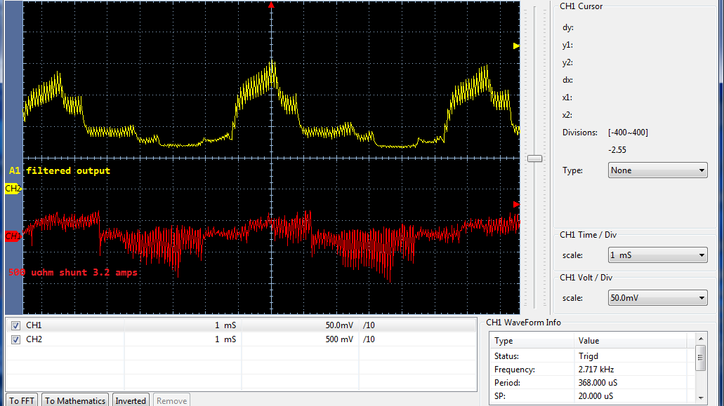

  • Hi Patrick,
    The excessive peak noise across shunt was measurement error of the scope probe being X1 where X10 reduced noise more respectively 9-16mv peak.
    Yet that is not explaining why 1/2 REF has no ability to reduce the peak magnitude of the A1 output during random transients and typical PWM peaks crossing the shunt. That is to say any shunt transient that reaches A1/A2 output exceeds the REF pins ability to constrain them being the transients attempt to reach VS pin 3v3 rail voltage. There seems to be scaling error in the output relative to VS 3v3 supply voltage and the 500uohm shunt should be creating under this current measure condition. There is no reason why ST current monitor 750uohm shunt 100 amp bar (75mv/A) can easily measure same low side PWM below capture but the 240 low side 10mv/A with SAR can not!
    Notice the shunt millivolts above capture  X1 probe and later with X10 below capture a true shunt signal is more revealing to how even 1/2 REF (620mv) output signal amplitude for 3.2-3.6 amps has excessive amplitude.  The amount of error is easily 30% no matter what the datasheet formula suggests. Below capture CH2 we see 2v peak - 1/2 REF (620mv) = 1.38v/10mv or 13.8 amp peak. The A1 output peak should be 10mv + 1/2 REF and 635mv/10mv/A or 3.5amps so the output has excessive unfounded magnitude! The INA output is violating Ohms law E=IR * 20 gain. Something in the INA use (not of our doing) is causing excessive gain A1/A2 which violates Ohms law as 12.5kHz PWM signal CMMV crosses the 500uohm shunt. That is in our opinion for TI lab technicians to figure out, not the customer to fall victim too.
