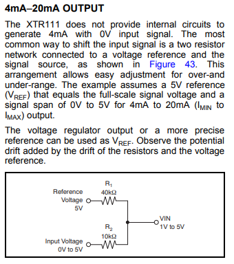

Input voltage range is 0v to 10v , So I have selected RSET = 4.99k. And I want output voltage 4mA to 20mA. To achieve 4mA , voltage divider used between Vin and REGF pin.

    1) According to datasheet if i want 4mA output, then I need to add resistor divider (my case R31 and R25) to provide 2V input signal to XTR while actual signal is 0v.
    Why to 2V because my input signal voltage range is 0V to 10V. So by referring fig.43 in datasheet. I have calculated R31 and R25 for 2V to 10V Input signal.

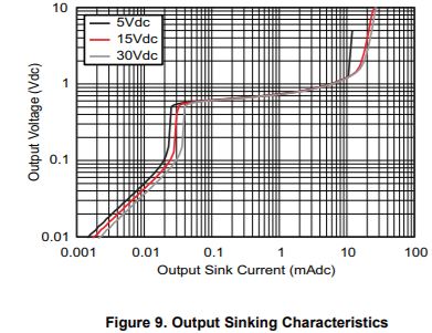

    It is not absolutely necessary to power the input circuitry off of the REGF pin, but as Kai mentioned this does guarantee that you wont exceed the REGF voltage. When you apply 10V at the input this could cause an issue with the regulator. At the low end, when your input is 0V then the LM158 must sink 10V/5.9k = 1.7mA. If you look in the datasheet for the LM158 however, according to figure 9 it cannot sink that much current and maintain a near zero output. This may be why you are not seeing a 4mA output.

    what Zak wanted to tell you was that you should increase R25 and R31, so that the LM358 must not sink so much current.
