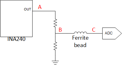

  • Hello BP101,
    Can you clarify if your output measurement is at A, B, or C on the diagram below?
    We are looking into adapting some low-side sensing boards we had for another device to fit our INA240 and investigate your claims.  When I have more details on that plan, I will let you know.  In the mean time though, I would like to confirm your operating conditions:

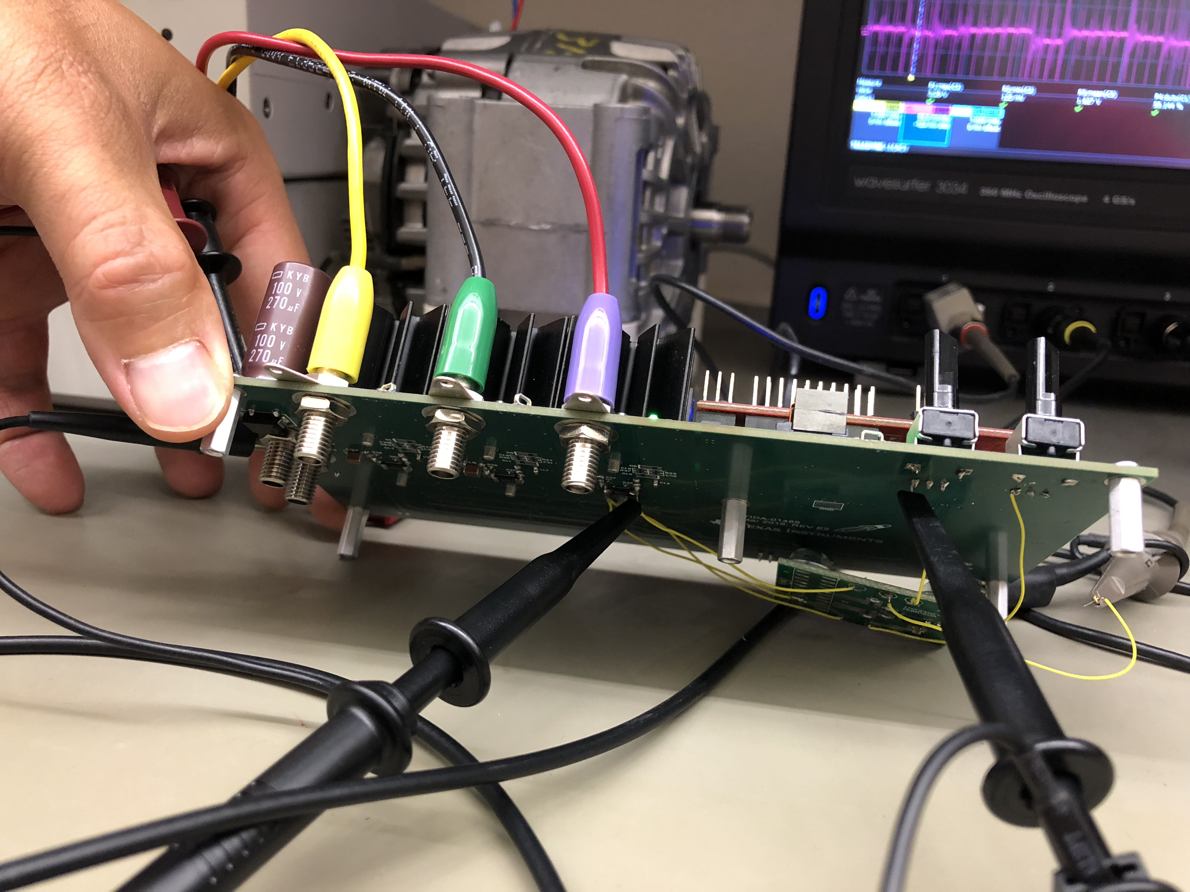

    Oddly it doesn't seem to matter where the scope probe is placed ABC as pluses are above mid supply. Multi layer MMZB102C ferrite or SMT 10uH Choke similar output ramping occurs. Resistively dividing output 4R87K to GND REF=620mv avoiding comparator fault tripping of output mid REF 1.224v and adversely creates random secondary over current fault conditions from rescaled transients.
    Yet the ferrite seems to clamp faulting transients the choke lets through. All the values you posted seem accurate, PWM duty cycle 0-20% being steady state current is below 10 amps. Each PWM period 12.5Khz=80us with roughly 15-20us on time during steady state speed so duty cycles 15-20%  around PI speed controller.

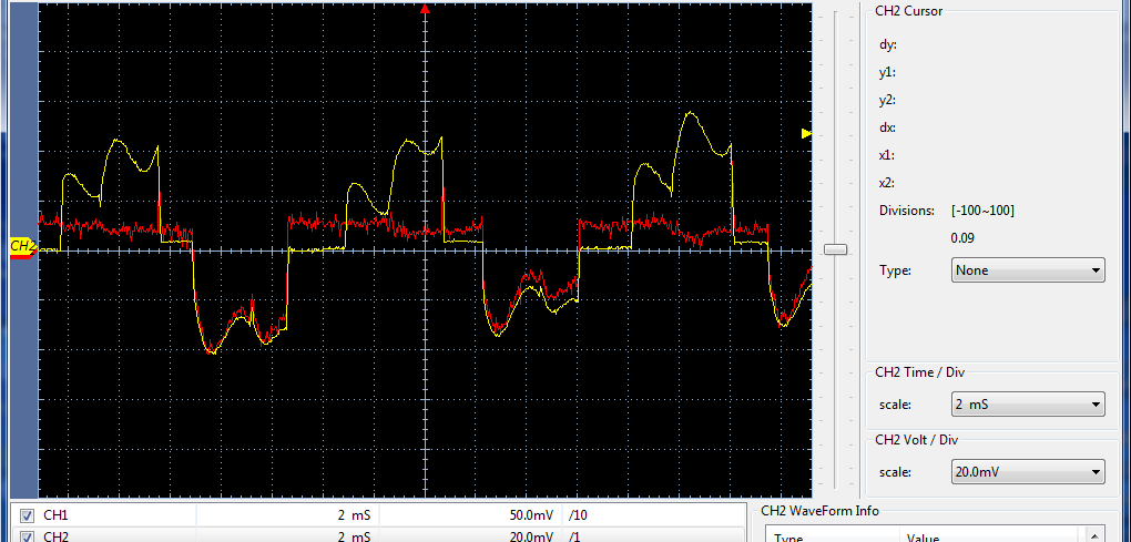

    Capture below we see A1 output goes positive as the shunt voltage drops, very troubling. Tina plots without SAR in analysis indicate the output voltage dropping relative to initial shunt CMMV set @20mV or 80mV to match A1 bench results. If the SAR is causing the output to rise it would seem the INA low impedance output is not fully compatible. The SAR Rs via Cext now at (22nf) keeps analog impedance roughly 570 ohms.  See table 1 SPNA118B–September 2011 explains our filter selection (Cext=10n-22n) for 1/2 LSB of TM4C1294NCPDT MCU embedded ADC 12bit/16chan SAR Csamp=10nf @2MSPS.
    Capture of first motor run, shunt CMMV drops yet output jumps far above REF. CH1 probe 10x, channel 1x not exact scaling but seemingly much closer to reality of Ohm's law E=IR 500uohm. The capture indicate roughly +/-8mA up to +/-2.2 amps

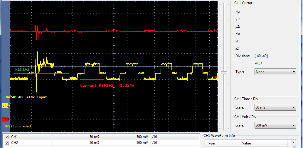

    The capture above and a few others show exactly that as the UCC27714 gate driver outputs are disabled until the PWM drive is 1st applied. The ADC is always running measuring bus voltage and other sensors, current samples occur 1.25us after PWM drive though A1 outputs are always active into SAR channels. There is little chance of cross talk as defined (SPNA118BSeptember 2011). The A1 three SAR channels are in line, isolated from other analog signals and show no indication of cross talking on the Cext filtered signals. Ideally larger values of Cext keep the SAR input impedance low relative to higher Rs values.
    Seemingly the same A2 inversion problem with EK-TM4C129XL and proto testing 240.Prior to custom PCB we put a patch on issue dividing output from REF set mid supply (1.65v) not fully comprehending A2 output signal behavior relative to shunt CMMV changes.
  • The system supply was 165vdc with EK-TM4C1294XL proto inverter, 240 output resistively divided 540mv from REF1/2 set mid 3v3 supply.
    Currently power supply remains 80vdc (linear) until 240 issue is resolved. Also 24v (linear) bucks to +5v via 1.5Mhz Rohm switcher regulator feeds 3v3 LDO for 240 VS pins.
  • Requested scope shot sampling A1 outputs. CH1 scale is low as it can be set and suspect 80 VDC supply noise. CH2 level shows A1 output resistively divided half REF (620mv) sampled @1ms intervals of 80us PWM periods.
