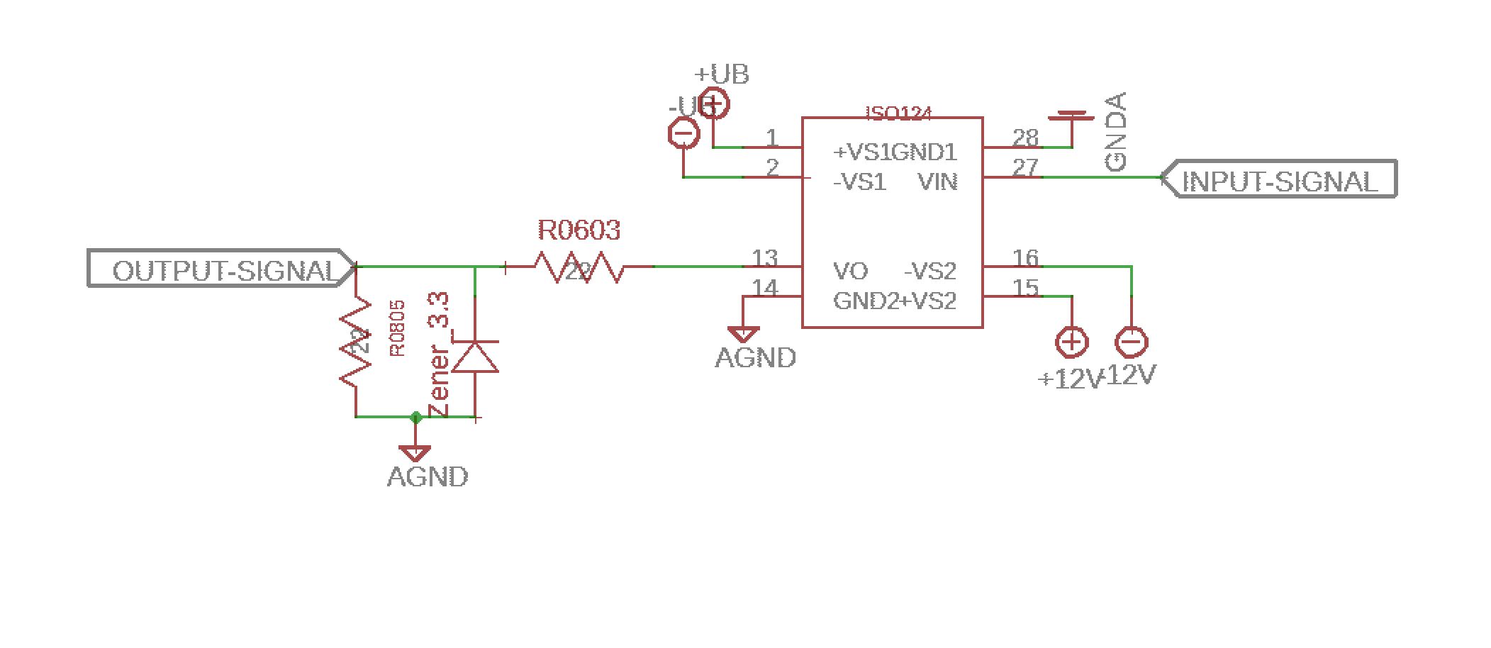

I am using the ISO124UE4 Precision Isolation Amplifier. I have designed and fabricated a board that get the data from sensors and send it to a processor. In order to isolate the input data lines and the processor I have used the ISO124. My problem is that they are getting hot when the board is working. The temperature goes high up to 45 degree Celsius. Is that normal or it should not be like that? Do you have any idea what have caused the high temperature?
