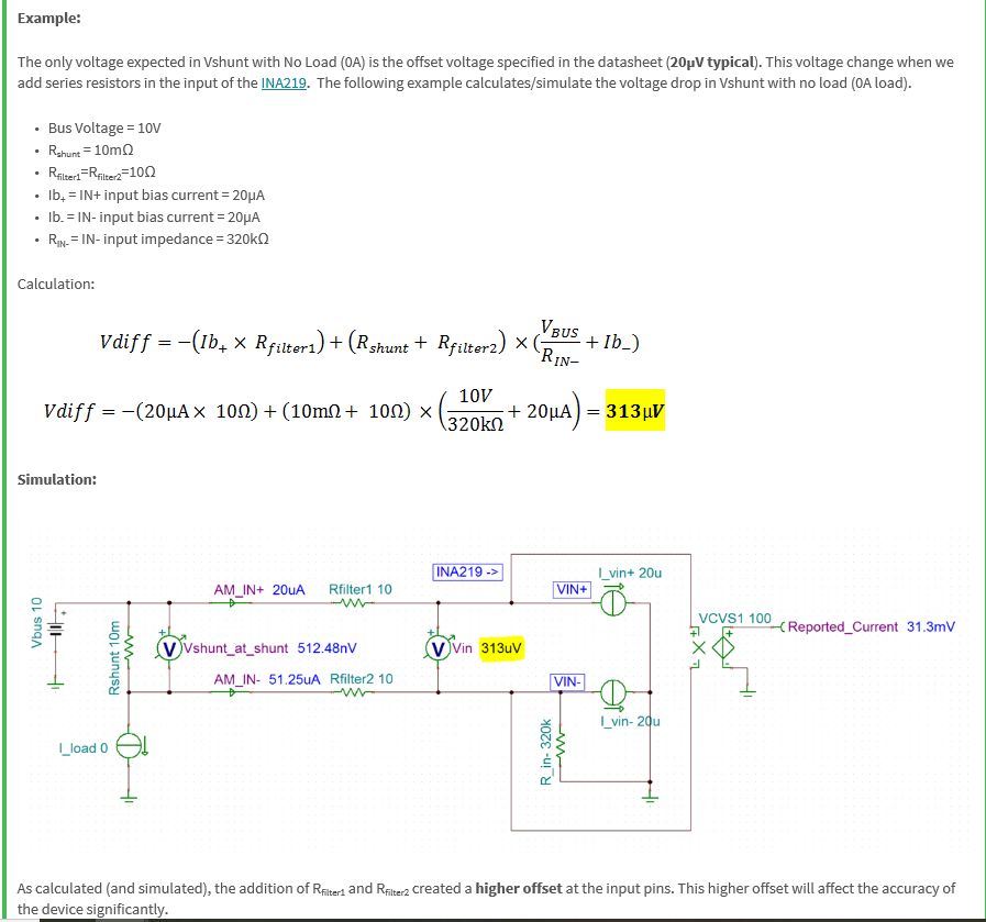

1.According to the blog ,there is three conditions:
a.When both Rin- and Rin+ are inexistence,Vdiff=0.2uV;
b.When Rin-=320KΩ and Rin+ is inexistence,Vdiff=313uV;
c.When Rin+=Rin-=320KΩ,Vdiff=100.3125uV.
How can we increase the accuracy of the current sensing by setting Rin-=320kΩ?Can you explain in detail?
2.Now that we add Rin-=320KΩ,and we know that will create unbalanced current.Why not add a Rin+=320KΩ to balance current?

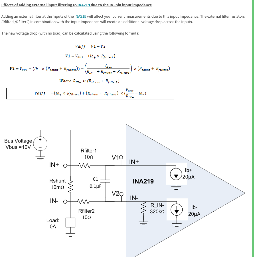

    To answer your first question you should understand that inside the INA219 and INA3221 there are physical resistances from the IN- pin to the GND pin. For the INA219 this resistance is 320kΩ and for the INA3221 this resistance is 670kΩ. These resistors are to measure VBUS and both of these values are in the respective datasheets. There is nothing you can do to this resistance, it will always be there.
    These internal resistors induce unbalanced input bias currents. For INA219, while IB+ will remain around 20µA, the IB- will be 20µA + VCM/320kΩ = 51.25µA assuming your bus voltage is 10V. Now usually this is not a problem when sensing current, but once you insert external filter resistors on the inputs Rin+ = 10Ω and Rin-=10Ω, then you will induce unbalanced voltage drops across each resistor, which will then increase your offset error as seen with 313µV.
    Now if you follow the last link on the last post, you will see the possible solution you could implement. This solution would be to add an external 320kΩ resistor from IN+ pin to GND. Once you do this then both IN+ and IN- will equal same current which will be very beneficial and improve accuracy if you have implemented an external input filter to the INA219. See below.

    What you mean is  inside the INA219 and INA3221 there are physical resistances from the IN- pin to the GND pin.Why do we need the  physical resistances?If we don't have the resistance from the IN- pin to the GND pin,what effect will it have on current sensing?
    "This solution would be to add an external 320kΩ resistor from IN+ pin to GND. Once you do this then both IN+ and IN- will equal same current which will be very beneficial and improve accuracy if you have implemented an external input filter to the INA219." So why not add an internal resistor from IN+ pin to GND in the original design?
  • Hey user5304320,
    The internal resistor for IN- to GND (320kΩ for INA219 and 679kΩ for INA3221) are there to only sense the bus voltage. These devices are actually power monitors because they measure current and voltage at same time and produce a power measurement.
    We don't add a balancing internal shunt resistor at IN+ to GND because it usually is not necessary. The imbalance in input bias current IN+ and IN- is only really a problem when resistors are placed on the input pins to the device. Once there is input resistors then the imbalance in current will turn into an imbalance of voltage drops resulting in a larger offset. Keep in mind that will adding a balancing resistor will improve offset, the internal resistor from IN- to GND can vary conservatively +-30%.

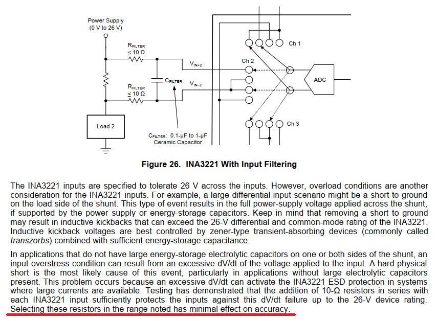

    the datasheet of INA3221 contains the following text:
    Well, the last sentence is somewhat misleading because an additional offset voltage RTI of 313µV is not at all a "minimal effect on accuracy". I think the datasheet should be corrected and it should discuss this issue in much more detail.
    Kai
  • Hey Kai,
    You are correct. The wording does not reflect the internal operation unique to this device. We have made an action to correct this. Thanks for the suggestion.

    I don’t understand why we need Rin-.What can it do when we  sense the bus voltage?In case the load  is shorted to ground and the power supply damages the IC?
    According to Kai's picture,we have to add Rfilter to aviod ESD protection.Can you explain how the Rfilter work to aviod ESD?
    Is the Rfilter  necessary for the IC?If the answer is YES,means that we don't have an application scenario without the Rfilter?
  • The internal Rin- resistors to ground sense the bus voltage because they draw current from the bus. This current equals VBUS/Rin-. The internal ADC will measure the voltage drop across Rin- (320kΩ or 670kΩ) to determine the bus voltage.
    The input Rfilter is recommended in INA3221 datasheet for two reasons:
    1. The sense current contains transients at harmonic of 500kHz.
    2. If VCM (common mode voltage) will change very quickly (large dV/dt) and there are no electrlytic shunt capacitors from IN+/IN- to ground.
    We list reason 1 because we do not want input signals to interact with the sampling frequency of internal ADC.
    We list reason 2 because continously switching the VCM very quickly from 0V to 26V will overtime damage the internal ESD cell structures. This situation would occur in the in-line current sensing of a H-bridge controlling a motor. This is why we describe this part only for high or low side sensing, not in-line sensing where the VCM can be pulled very quickly from ground to a high voltage repeatedly. For an in-line application we recommend the INA240 because we manufactured this device with PWM rejection internal circuit. The IN240 uses different ESD cell structures that are made to withstand fast-switching VCM. The INA3221 was not.
    Anyway, if your system cannot avoid fast switching of VCM and you cannot insert electrolytic capacitors at the input to slow down the VCM the INA3221 sees, then you can resort to adding the Rfilter. The Rfilter helps because it limits the current sunk into the device input pins and ESD cells during a high dVCM/dt event.
    A third reason you would add the Rfilter is if you expect large VCM transients greater than 26V at the inputs. The datasheet suggests using TVS diodes or tranzorbs to clamp the input voltage and divert current, but a Rfilter network would help limit the current and thus power needed by TVS diodes.
    If you end up needed a Rfilter network for whatever reason, you could consider the INA190 which has a much lower input current of 2 nA. This would allow you to use a much high input resistor (e.g., 1kΩ) without sacrificing much on accuracy.
