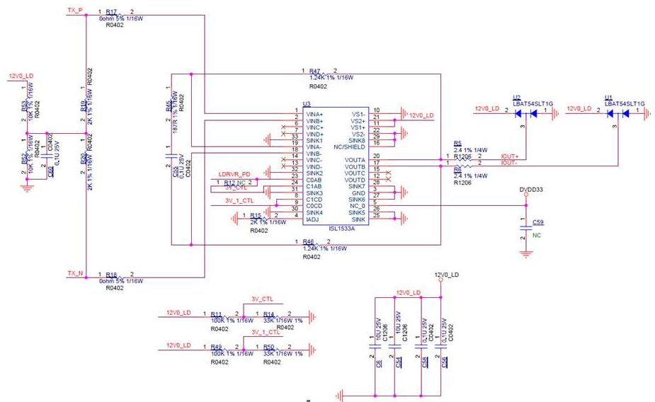

Dear E2E member,
Our customer use ISL1533A solution, and THS6212 is P2P solution.
Does THS6212 can replace ISL1533A directly? Is it B2B solution?
Which protection component sould we add in output differential?
Thanks!
  • Hi Julian,
    Comparing their pin configurations, it appears that ISL1533AIRZ Has active signals where THS6212 has No Connect pins. This is generally not allowed unless you are somehow able to float them. They are sometimes used for testing programs and are connected to nodes on the die.
    Sean
