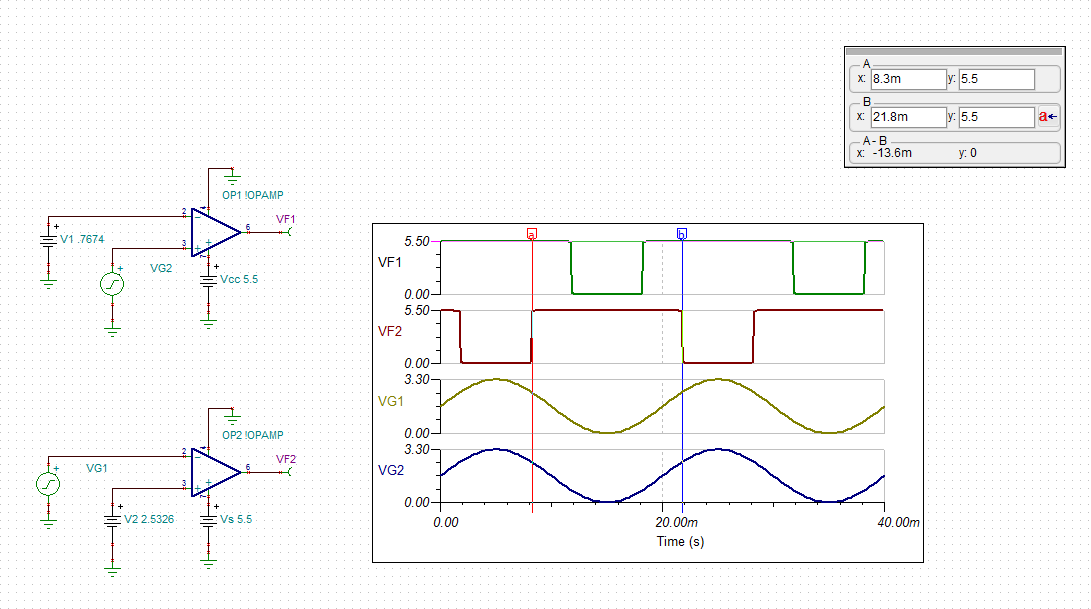

  • Following Ron's calculation, you may determine that to get 68% duty cycle on 1.65V amplitude sine wave, you must place the tripping voltage of comparator at 1.65V*cos(122.4)=0.8826V above or below center of sinusoid waveform (depending on chosen circuit polarity- see below); thus, for 0V to 3.3V peak-to-peak signal, the center is at 1.65V and the treshhold voltages must be:  1.65V+/-0.8826V = 2.5326V or 0.7674V.  Applying these voltage will give you 68% duty cycle as shown below:
     Duty cycle calculation.TSC

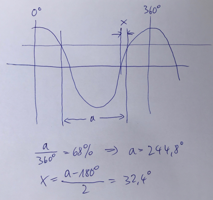

    May I know how you obtained "crossing occurs at +/-34% from 90 degrees. " ,is it 32% .If you don't mind could you please explain with a diagram,will help me to understand better.
    The way I understood your equation (A * sin ( angle ) + DC[voltage].) is given below.Please correct me if I am wrong

  • Hi Hari,
    Kai

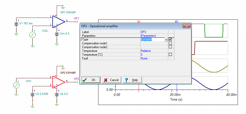

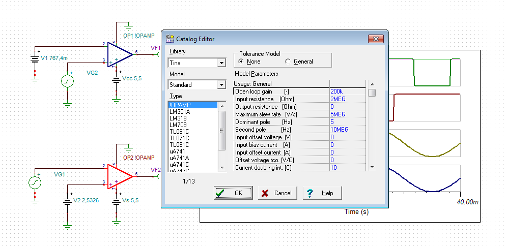

  • Hi Marek,
    Could you please tell me how to take the spice macro "OP2 !OPAMP" . I went to spice macros->opamps, but I was not able to see anything like OP1. I am new to TINA just started studying it. This "OP1 " is a universal opamp model available TINA TI like LtSpice.
    Hari
  • Hi Hari,
    open the TINA-TI file and double-click onto the OPamp:
    Click on "..." and you will find the parameters of OPAmp:
    Kai
  • I have attached the schematic in my previous post with the OPA1!OPAMP.  OPA1!OPAMP generic model is under Semiconductors tab and you may freely change its parameters by clicking on the symbol - see below:
  • Hi Marek,
    Thank you very much,got it.I searched in spice macros that why i was not able to see.
