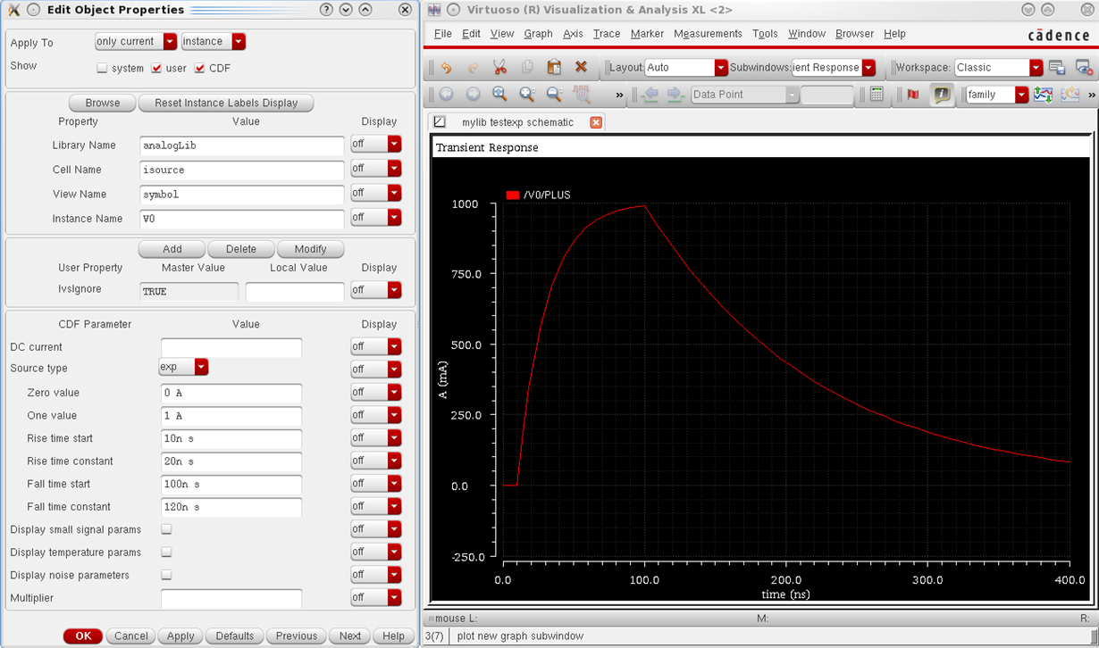

I want to generate a double-exponential current pulse using XTR111, as shown below.
By applying a double-exponential voltage pulse as the input for XRT111, I hope I can get a current pulse with similar shape. But the spectrum of the voltage/current pulse can reach up to ~5 MHz, which is beyond the XTR111 bandwidth (~ 1MHz, shown in Figure 3 of XTR111 datasheet), so I am wondering if the XTR111 can be used to generate the expected double-exponential pulse? Are there any other amplifiers that would be a better choice to generate the current pulse?
