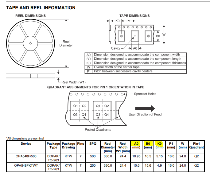

Hello.
As I know MPN OPA548F/500 and OPA548FKTWT just different quantity for tape reel, but can anyone advise about the size for both MPN? Is it same size? What about the difference value labelled A0,B0 and K0?
