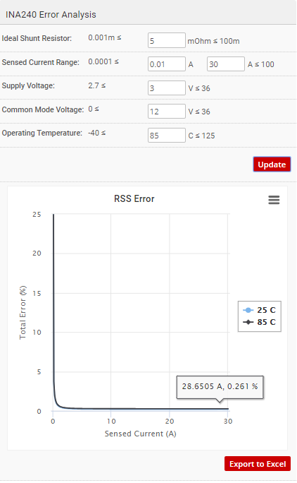

I want to use single setting with fixed Rsense and Fixed gain (20 to 200 which ever suits). Output voltage 1.0V-3.0V range where Rsense will be in series to load:
1. Power supply output 0.8V-3.0V. If Rsense is 5.0mohm and in high-side sensing. What is the minimum Load current  we can accurately sense. What would be the gain setting. Can REF1/REF2 be tied to GND?

    1. The INA240 needs a minimum supply of 2.7V. The minimum load depends on the amount of error you can tolerate.  All current measurements will have some error.  The error will increase as the load decreases.  Below shows an error curve for certain operating conditions.  How, I chose the upper load limit will be discussed in #2.  The error curve tool can be found on the right side of the product page.
    2. The maximum load is determined by your device supply, which is roughly equivalent to the max output.  For the largest load, you will need to use the smallest gain (20V/V).  Thereupon the max load is supply/gain/Rshunt = 3V/(20V/V)/(0.005ohm)=30A.  This is assuming your REF pins are tied to ground.  Otherwise max load will be (3V-REF bias point)/(20V/V)/(0.005ohm)
