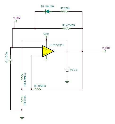

On the suggested schematic, i would like to change the RC network so i can have a 1Hz pulse with 10-20msec duration.
I don't know how to calculate the resistor/capacitor values.. can you help me please?

for additional information, please see our latest cookbook circuit on building relaxation oscillation circuits. In that document, you will see that R2, R3, and R4 can be adjusted in order to create a duty cycle other than 50%. A TINA reference circuit is also included in the cookbook to assist you in simulating your circuit.

if the duty cycle is far away from 50%, I would use the double feedback technique, using one feedback path for the high time and the other for the low time:
When filtering the supply voltages powering the OPAmp and the voltage divider R3 / R4 and when using high quality foil capacitors for C1 and C2, the circuit will be surprisingly precise.
I have used high ohmic feedback resistors to save supply current. R6 is needed to limit the input current.
The output signal can also be inverted by reversing the diode. But the circuit will draw much more supply current then:
I certainly need not to mention that such a high ohmic circuit needs good shielding against hum and interference.
Kai
The correct value of R1 depends on the actual capacitance of C1. As capacitances usually show huge production tolerances, you might want to select one cap with low tolerance from a handful of caps. After that adjust R1 until the period time is exactly 1s.
Don't decrease R3. As the output voltage of TLV7031 cannot fully go down to 0V, this would make it harder and harder for the comparator to toggle.
