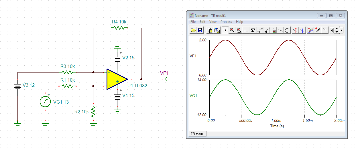

WHY IS THIS OPAMP(TL082) NOT WORKING AS SUBTRACTOR (UNDER LOW DIFFERENTIAL INPUT & GAIN=1)? Application diagram is same as the diagram in the link. In the circuit, V2 range is 12Volt to 14Volt, V1 is 12Volt and R1=R2=Rf. And suggest an opamp that works in low differential input voltage. Thanks
