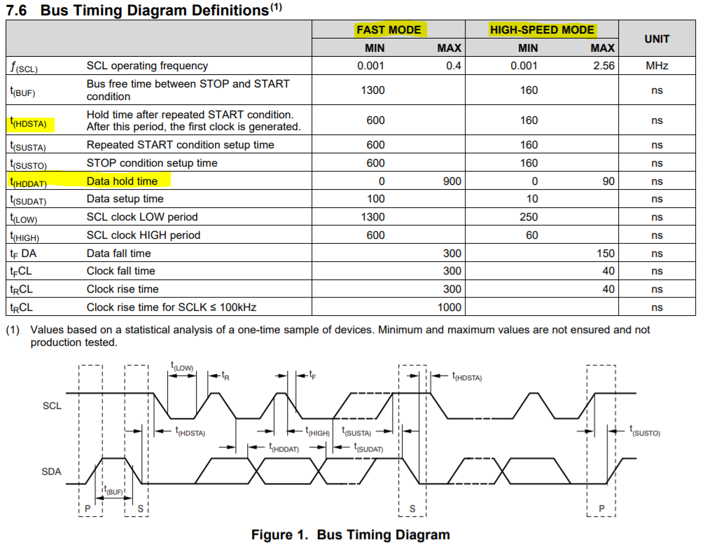

Hi Team,
Could you please provide the Data Hold Time information (t(HDSTA) & t(HDDAT)) in Standard Mode (100 kbps)? Thanks!
The datasheet lists the information in Fast and High-Speed Modes only.

    Thanks for using the forum. The bus timing specifications provided for fast mode also apply to standard mode.

    What’s the concern from customer is the max Data Hold Time in Standard Mode. In this mode (100K Hz), the clock frequency is much slower than Fast Mode (400K Hz) so the half cycle is 5us. We think the data is still valid for Master as long as the data hold time is less than 5us and we don’t understand why the data hold time should be limited less than 900ns for standard mode. Is there any risks if the timing greater than 900ns? Could you please comment on this? Thanks!

    I originally got the details wrong on the operation of this part.  Sorry for that.  The following is what one of our design engineers told me with regard to the specifications of this part.  Firstly, the specs we have adhere to those defined by philips (now NXP) for the I2C protocol.  To see those specs you can go here, page 48.  According to those specifications, you can determine what the max tHDDAT should be based off of the tSUDAT, trise, tfall, and thigh times.  Lets use your 100KHz and assume that your clock and data lines have rise times of 1000ns and a fall times of 300ns.  We will also assume your time period where the clock is high is 4 us.  With a 100KHz clock, your clock period is 10us.  If we evaluate one period of the clock, we can determine the remaining time that corresponds to what tHDDAT must be so that the slave and master devices can communicate.  In this case we have Period -data transition time (max) -data setup time- clock rise time- clock high time - clock fall time =10us-1000ns-250ns-1000ns-4us-300ns=3.45us.  If your rise and fall times are shorter or your frequency is smaller, this hold time can be longer.  If your hold time exceeds whatever you calculate for the conditions you impose with your clock and pull-up resistances, you may have communication errors as the data and clock will no longer be operating on the same frequency.
