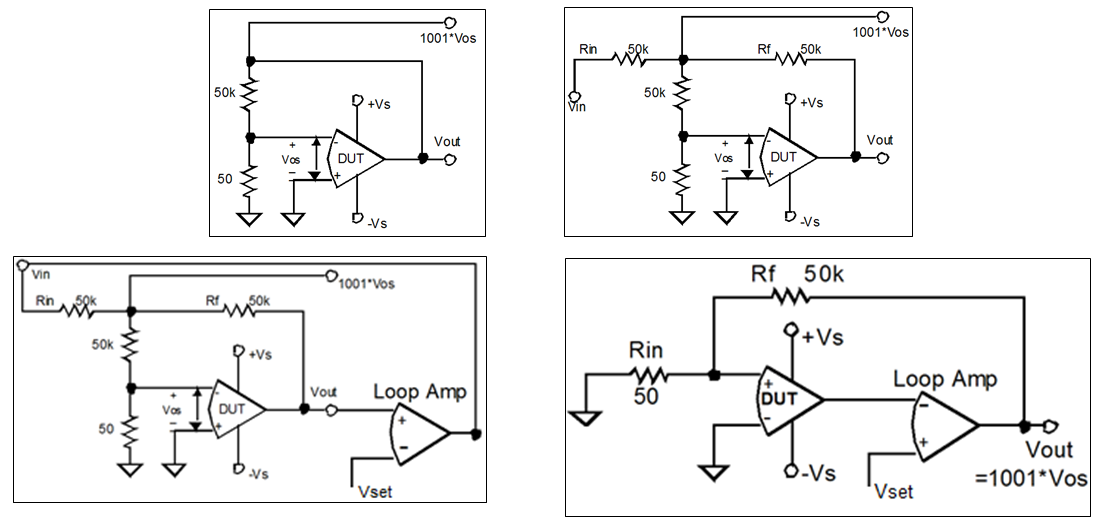

My customer is considering LM2902 and has questions about device function test.
I would be grateful if you could advise.
We'd like to conduct a kind of stress test (thermal, shock and etc) and confirm deterioration of the device.
And then we perform a simple test of the device before and after the examination and confirm the difference.
I picked up specific items.
Are these items sufficient?
· Current consumption
· Input offset voltage
・Supply Voltage Rejection Ratio
・Input Bias Current
・Input Offset Current
・Voltage Gain
・Common Mode Rejection Ratio
·Output Voltage H level and Output Voltage L Level
Could you please provide the test circuit your recommend.
I appreciate your great help in advance.
Shinichi
  • Hello Shinichi-san,
    Some of this will be difficult and time consuming to do on a lab bench. Some tests below are close to data sheet conditions but not exact.
    ・Voltage Gain
    All the tests above use Vio at one or two device operating points.
    Top left schematic is measure Vio when VOUT = VCM.  Top right when VOUT not same as VCM
    Bottom row is simplified servo loops. Actual circuits are more complex.
    Measure ICC in unity gain, set Vin to 1V or similar.
    ・Input Bias Current
    Measure input current with one input a 0V and the other at 10mV
    Apply at least 1V input difference, add load to output 2k or 10k to ground.
