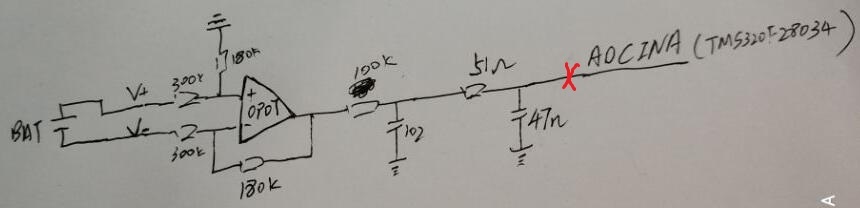

OP07: Calculation of output impedance of operational amplifiers in practical use
Part Number: OP07
Other Parts Discussed in Thread: TINA-TI
Hi, TI engineer!
As shown in the above figure.Input is battery voltage.OP07 operational amplifier differential.Input to DSP ADC pin.How to calculate the output impedance of the operational amplifier in the red mark position of the picture(It is also the input impedance of ADC.)Please help me.Thank you very much.
