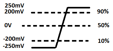

what mean the TEST CONDITIONS "0.5V step ,50% to 10%" and "0.5V step ,50% to 50%" and "0.5V step ,50% to 90%"?

The percentages correspond to where in the unit step the measurement is being taken.
I drew a crude picture showing the unit step applied to the input below to help illustrate.
The value in the datasheet is the amount of time that it takes to see the particular point on the unit step on the output.
