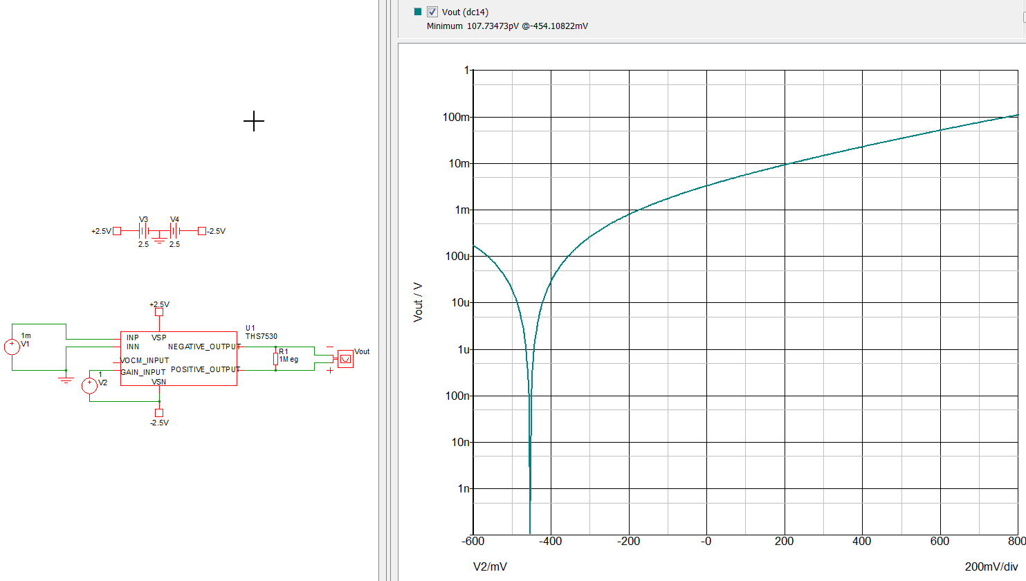

I would like to use this part the Vcom at 0V. I'm using a +/-2V power supply.
What will be the VG- Referenced to? Will the voltage range still be 0 to 0.9V in this case?

    I'm actually using +/-2.5V power, sorry for the confusion.
    I was using the simulation to test for this configuration and noticed that there is dip in the output profile with a minimum at -0.454. Do you know what may causing this? Does the range of control voltage supposed to be > >-0.300V

  • Hello Youssef,
    The gain control of this model is a simplified version of the control on the part itself. Notice that the model does not include both VG- and VG+. Think of the model pin as VG+, with VG- set internally to Vs-. That dip is a result of the device exceeding the differential voltage range of 0V-1V, or in other words the gain control pin should not be set outside the range of -2.5V-1.5V when Vs- = -2.5V.
