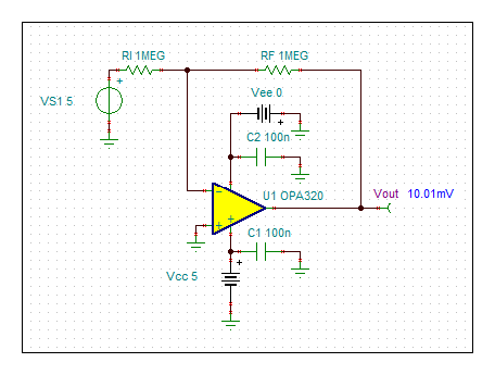

Hi team,
 When I simulated a buffer circuit with OPA320 by using TINA-TI,
 the minimum value of the voltage output swing from V- rail(GND)
 was approximately 84mV.
  *Please see the attached file.
opa320_sim.xlsx
 I think this value(84mV) is very higher than the value listed on the datasheet.
 Is the result of simulation correct?
