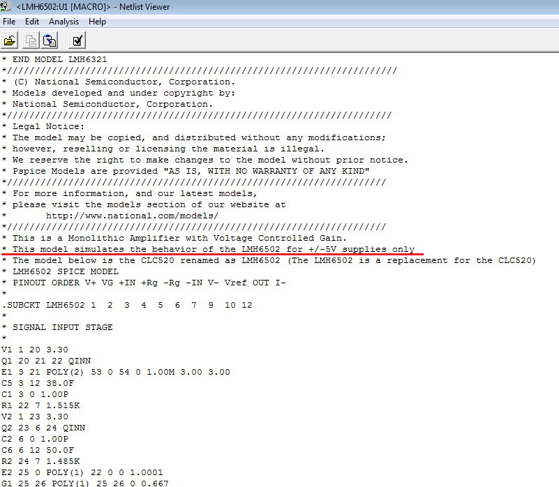

I use LMH6502 with single power supply according to the datasheet Figure 61, but when I simulate with TINA , the result is always a DC signal and close to saturation.
Please help to check .

The main issue here is that the LMH6502 model is only meant to be used with +/- 5V supplies. I've attached another schematic with these supplies so that you could use for reference. As another note, when using this device in single supply operation, the Vg pin will need to be set to 8V rather than 2V because the GND pin is now set to mid-supply.

the LMH6502 TINA model simulates the behaviour of the LMH6502 for +/-5V supplies ONLY!
e2e.ti.com/.../2774008
It will NOT work for your +/-2.5V supplies.
