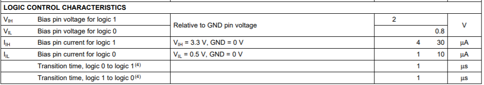

I have an application where the BIAS-1 and BIAS-2 lines rise very slow and I wish to know if the THS6182 can handle it or it may create any problems.
If those inputs are Schmidt-triggered I guess there will be no problem, but this information is not listed in the datasheet and that's why I post this scenario.

    The "Logic Control Characteristics" section of the datasheet shows the voltage levels needed for each logic state.
    Voltages between 0.8V-2V may give a different logic level than desired and like you mentioned Schmidt-triggered inputs can help fix this issue.

    My question was: Can the THS6182 be damaged if voltages between 0.8V-2V are applied for a long period of time?
    Usually the input voltage drives 2 FETs, to GND and to VCC(3.3V or 5V rail) when the output circuit is a push-pull configuration.
    In some cases an intermediate voltage can turn ON both FETs resulting in a HIGH current from the voltage rail to GND.
    When the transition is fast, this state is very short or does not happen at all, but if the transition is slower, the high current can generate enough heat or damage the FET's if they're not rated for this condition or current.

    Thanks for the clarification. After looking into it, it looks like the voltage level of the Bias pins are not a concern in regard to the damaging of this device.
