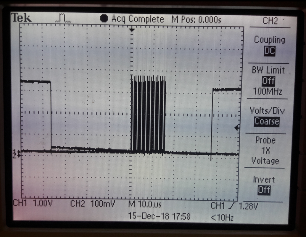

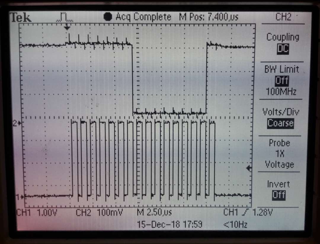

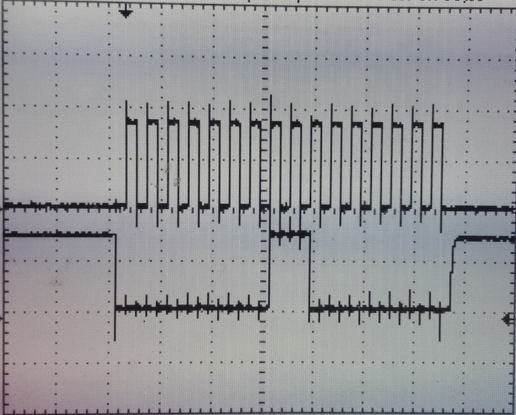

Hello!
I am trying to program the gain of the LMH6517 via SPI using a beagleboard, but that does not seem to work. I already checked the communication lines on the oscilloscope and everything seem fine, so I would like to know if anyone can help identify what the problem is.There is some fixed gain there because I get an amplified signal out of it, but it does not change. The latch pin should not matter when spi is in use so I wonder what could be happening.
This would be the python code:
from Adafruit_BBIO.SPI import SPI
spi = SPI(1,0) #configure device and bus at beagleboard
spi.msh = 10500000 #clock
spi.bpw = 16 #bits per word
spi.open(1,0) #opens it
spi.xfer2([128,0]) #transmits data
Thank you,
JPL
