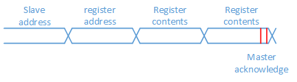

    Thanks for considering to use Texas Instruments.  When you transmit to/read the mask enable  register of the INA226, the conversion ready flag bit is fixed until the bit from the master acknowledging data from the INA226 is sent.   So if the conversion completes while sending the request to read that register,  you will only see the results of the previous conversion.

    Please tell me about question 1 and question 2 in the figure below.
  • Hello user4959393,
    The design engineer said that if you manage to sync the conversion completion with the master acknowledge, the conversion flag will never be set high. The conversion ready flag is intended for one shot measurements to indicate that you can grab the measurement result. For a continuous measurement, clearing this flag will not clear the measurements stored in the registers. Ideally to avoid such a scenario as posted above, we recommend you read every 1.5 conversion cycles.

    When conversion completion is synchronized with master acknowledge,
    I understand that Conversion Ready Flag is never set high.
    Will Conversion Ready Flag be set to high unless it is synchronized with
    master acknowledge at the next conversion completion?
    Yes it will be set to high.

    I wanted to detect Alert Pin with a falling edge interrupt,so when conversion completion synchronized with master acknowledge on initial clearing, I was relieved that Alert Pin did not become a fixed level.
