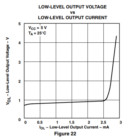

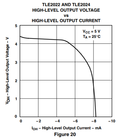

    During a fast transient event the op amp output will attempt to slew to the necessary output voltage level. While slewing the output stage must supply whatever current is necessary to charge that capacitance. A 47 nF capacitance is a huge capacitance load. If an operational amplifier such as the TLE2024-Q1 is expected to charge the capacitor the required output current will follow the i = C dv/dt relationship. Any resistance in series with the capacitor will limit how quickly, and how much current will be available, to charge the capacitor.
    In conditions 1 and 2 there is a series output resistor, 2.4 kΩ and 68Ω, respectively. For condition 1 the resistance is high and the output current demanded from the TLE2024-Q1 will remain low - likely no more than a few milliamperes. The result is a long charge time for the load capacitor. When the resistor is changed to 68Ω in condition 2, the demanded output current would be much, much higher.
    If you review the TLE2024-Q1 datasheet Figures 20 and 22 shown below, you can see its output current source/sink capability for a +5 V supply. Typically, it can only sink about 2.5 mA and source about -5 mA, before starting to saturate. It does not have a high output current drive capacity and therefore cannot charge a very high capacitance such as 47 nF quickly. Essentially, the output transistor's saturation resistance limits how quickly the capacitor can be charged. I suspect the current limiting is the reason the transient response it not as expected for the condition 2, 68Ω resistance.
    Reducing the load capacitance by a significant amount should help. Otherwise, I suggest using a fast, high output current capable op amp instead of the TE2024-Q1.
