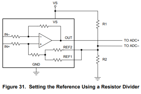

I need something similar INA226, which I used in the past but with analog output instead of I2C for current sense on high side of 48V input.
I found INA240, which I think should work.
I also need a differential analog output from the current sense, with output rating 0 to 5V,  so is there device that has that builtin?

    Thanks for considering to use Texas Instruments.  If you are looking to have the current shunt monitor produce a differential signal with respect to a reference voltage you can use the configuration shown in the figure below.  With a 5V supply the output will at worst be able to swing from 10mV to 4.8V.
    If you are looking for a analog output device that provides a current measurement, vbus measurement, and power  measurement through an analog output, we do not have one.  All of our power monitoring devices utilize an I2C interface for the output.

  • Hello Khoi,
    I had to make sure that was the case as another customer just recently requested for a power measurement device with an analog output.
    Based off the details I have, the INA240 does appear to be the best analog output replacement for the INA226. Let me know if you have any further questions.
