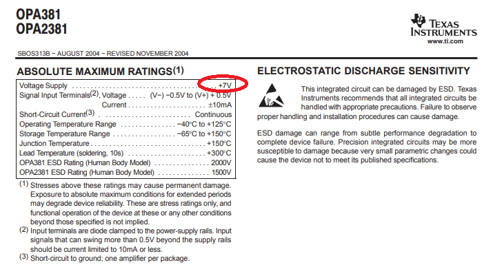

I'm trying to make some optical head with diode laser and OPA381 trans-impedance amplifier. Parameters of laser diode direct me to use 6v supply.
Is it safe to apply it to OPA381 without any sufficient degradation of its parameters, however in datasheet its regular Vs value is limited to 5.5v?
