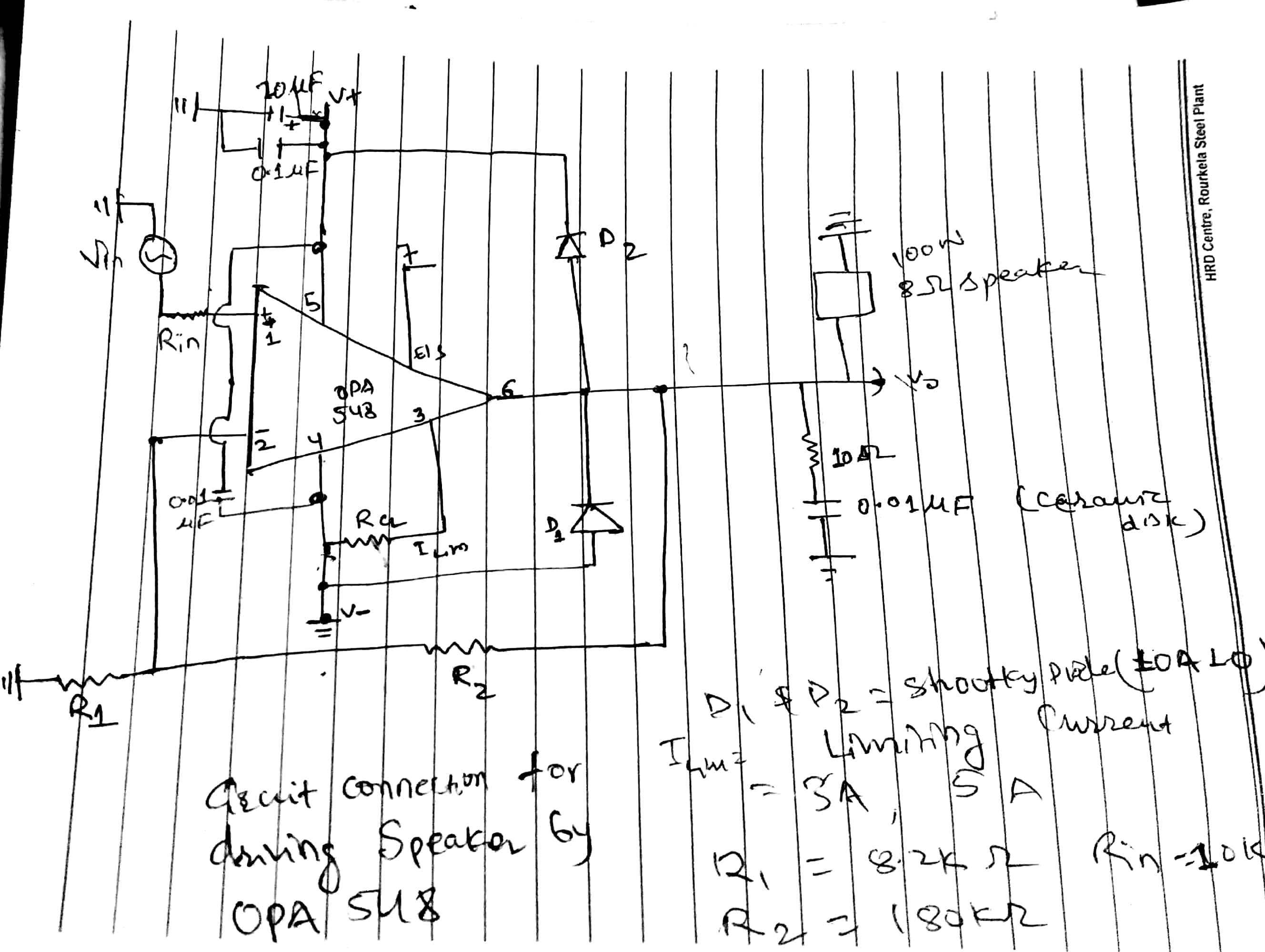

  • Hi Thomas,
    Attached here is a circuit schematic.
    input voltage=1V,
    Amplification= 1 +R2/R1=~23,
    power supply = 28-30 V, 3.5 A
    Output voltage (expected)=23 but I am getting less than 0.5 v.
    output is a 100 watt speaker with Impedance=8 ohm
    As an input signal,i am giving a half square wave, a ground to positive trapezoidal signal.
    Initially, it was working absolutely fine with any such signal and above input paramet ers, But all of a sudden, the output decreased.I tried re-building the circuit and testing again.But, this doesn't seem to help.

  • Hello Dipenda,
    Is the OPA548 V- pin really connected to ground? If so, that is a problem. With a dual supply the input is referenced to ground and the input and output signals are in the center of the op amp's linear operating range. If the op amp is set up with a single V+ supply then they must be referenced near mid-scale, or 1/2 V+ to assure operation within the linear input and output ranges.
    The circuit as seen applies the input signal to the non-inverting input which has a common-mode input voltage range (VCM) of (V–) – 0.2 to (V+) – 2.3. If the input signal is small and doesn't exceed the low-end VCM range that is okay as far as the input is concerned. The big problem is the output which is slammed up against the negative output swing limit and can only swing upwards from there. The OPA548 Vo negative is typically (V–) + 3.3 V for Io = 3 Amps. So the output is going to be slammed at +3.3 V until the input becomes positive enough to move it upwards and away from that rail. When the output is against a rail the op amp is not operating in its linear region and not really functioning as an op amp.
    If you have to use a single +V supply, AC couple the OPA548 input and output circuits. Use an input capacitor and a voltage divider to bias the non-inverting input at 1/2 V+. Add a capacitor in series with R1 as well, and a big capacitor in series at the output R2 connection to the load.
    Confirm the non-inverting and inverting inputs and output are at 1/2 V+ without an AC applied.
    Regards, Thomas
    Precision Amplifiers Applications Engineering

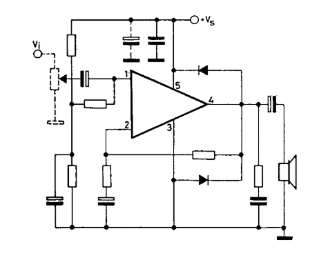

    But Thomas is totally right, your circuit looks really weird, if this is a typical audio application. Usually a bipolar supply voltage is used to drive a loudspeaker. If you choose a single supply voltage, on the other hand, you must bias the input with a midsupply reference voltage and use DC blocking caps at the input, within the feedback loop and at the output, like shown in this example:
