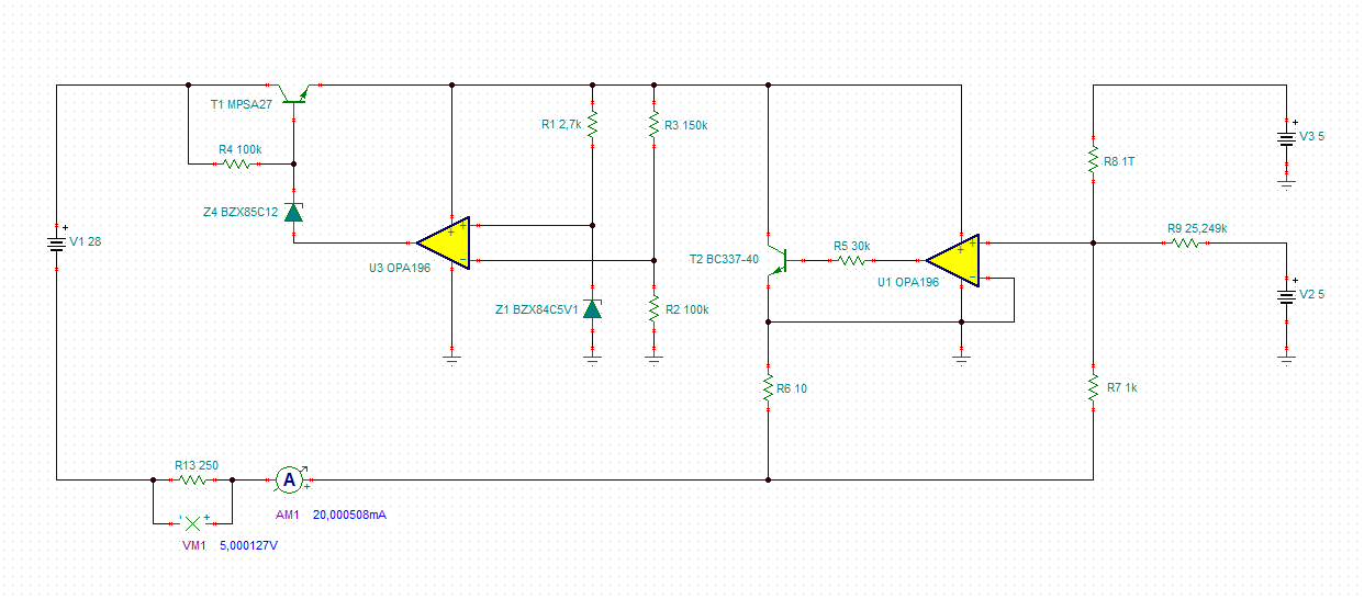

In what condition the inverting and non inverting inputs are not equal in negative feedback op amp ? I am making a simple voltage regulator . I have set my non-inverting input to 5V, thru a zener. My inverting input is fed back thru a Darlington pair and a voltage divider. I measured voltage between inverting and non inverting to be  800 mV !! Shouldnt the difference be a few mV max ? Thanks
The Op Amp that I am using in the circuit is: TL35072P. Thanks

  • Paul, thanks for your reply. I have attached my circuit.  The circuit is a 4-20 mA circuit. The left part of the circuit is the voltage regulator. The right part of the circuit is the 4-20 mA generator. The RB1 and RB2 simulate my Wheatstone Bridge sensor. The inverting & non-inverting inputs of both channels of my TL35072P do not follow each other. The difference is about 800 mV !! Thanks

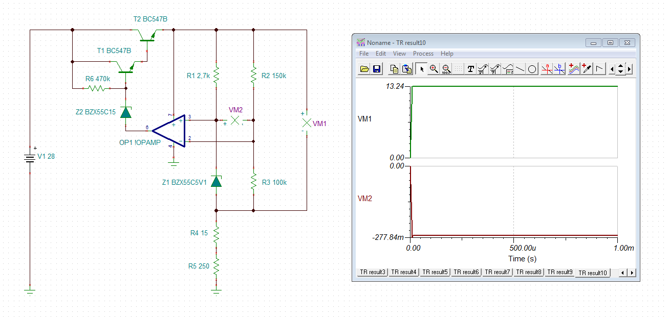

    for Z2 (in my circuit!) take a zener diode with a smaller threshold voltage:

  • Hi Nader,
    the minimum output voltage of OPAmp is 0V (when neglecting the current flow through R4 and R5 for simplicity). So, the cathode's potential of zener diode is at least +15V. The emitter voltage of T2 is 1.4V lower than +15V, makes +13.6V. But R2 and R3 try to program a potential of 12.5V at the emitter of T2. So, the output of OPAmp would have to go negative to fullfill this. A potential of -1.1V would be necessary, which is impossible, of course.
    An alternative is to reduce the zener voltage by 1.1V, better a bit more, to avoid saturation of OPAmp output. When choosing a zener voltage of 12V, an OPAmp output voltage of 12.5V + 1.4V - 12V = 1.9V is necessary to keep the OPAmp in regulation, which can easily be accomplished.
    To make things more complicated, the GND pin of OPAmp sits at the ground pin of R5 (other than shown in my simulation) and an additional current is flowing through R4 and R5, additionally shifting up the output voltage of OPAmp.
    Why not running your own simulation?
    Kai

  • Hi Kai,

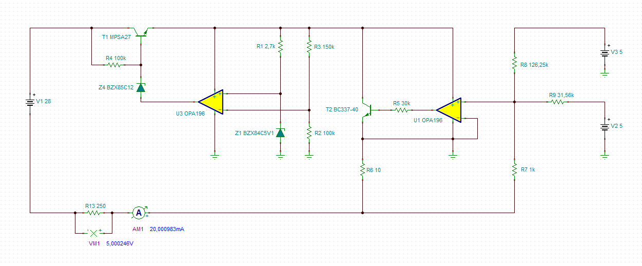

    Thank you. I corrected my circuit. My Op-Amps were connected to wrong Power rails.

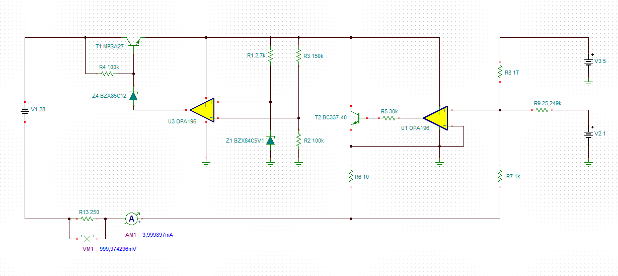

    If you include INA122 in your sim cir, you will see that the output of the INA122 would be around +320 mV for the case when In+ = In- ! In order to adjust the offset pin, I wanted to add a buffer circuit connected to the offset pin of the INA122, but my circuit is a single supply circuit and I do not have a negative rail to bring down the +320 mV output to zero.
    So , in general, what is the way for adjusting the offset pin in single supply circuits ? Thanks
  • Hi Nader,
    there's a simple trick: Use the REF input of INA122 to generate a defined output offset voltage of 1V for the case that IN+=IN-. Set the whole measuring range to 1V...5V. 5V / 1V is the same quotient as 20mA / 4mA then! By this you can remove R8 and adjust R9 to R9  = 25k249:
