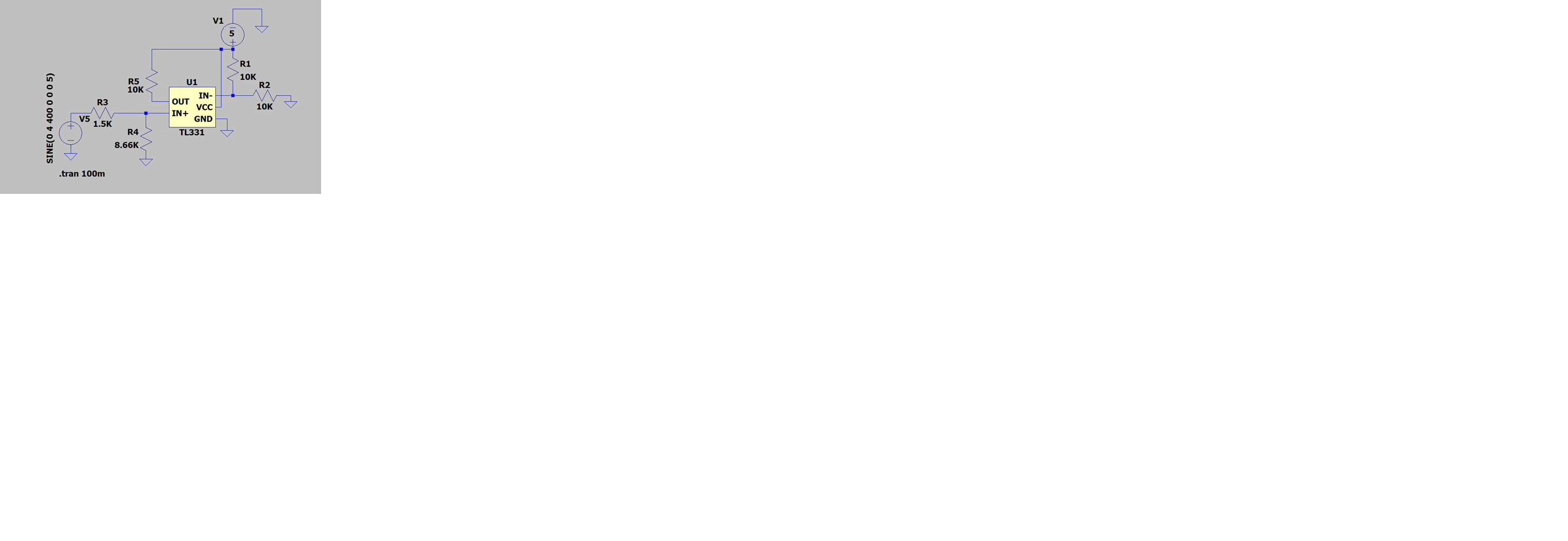

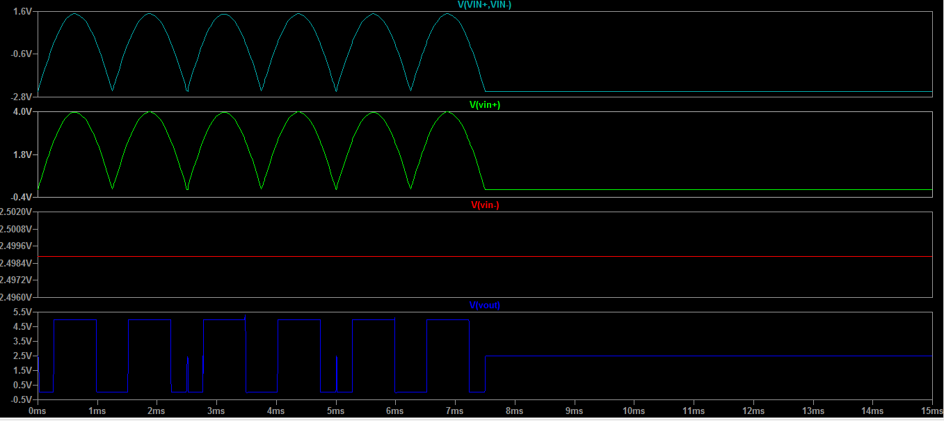

I am using TL331 for one of my application as simple comparator. (Without hysteris).
I have set the Ref as 2.5V to inverting pin and given sign wave of Amplitude 4V and Freq 400Hz to non inverting pin. I am seeing a glitch in the output waveform. Can you help me to sore this Issue.
Attaching the sch and waveform for your review.
