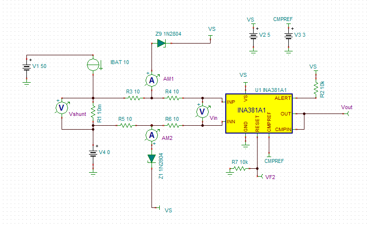

I am looking for a shunt-based over-current protection solution for battery pack application. The figure 50 of INA381 datasheet fits right in customer needs. The nominal voltage of PACK+ is ~ 50V so the current sensing feature would be implemented on the low-side.
INA381 specifies a -0.3V negative common-mode voltage limit in the datasheet. However in such battery protection circuitry there would be some negative swing on the PACK- terminal during over-current cutting off. I think adding some schottky clamp to INA381 GND would work for this situation. Could you please help to share some ideas about clamping the negative swing on INA381 IN+/IN- pins?
Peiheng.
  • Hey Peiheng,
    I have a FAQ post about this exact need for current sense amplifiers. The links for this are below and discuss general options available. Note that in the solutions I present here I include 10Ω resistors to limit the current into the clampling diodes, but customer may want to consider adding another pair of 10Ω resistors directly at the inputs IN+ and IN-. These would limit current into the devices, which will help improves robustness. I have included the schematic of what I am suggesting below. I have not proven this will work or there are Zener diodes available with correct reverse bias break down to support this. I inlcude this schematic so customer will know what I am trying to suggest with the extra input resistors.
