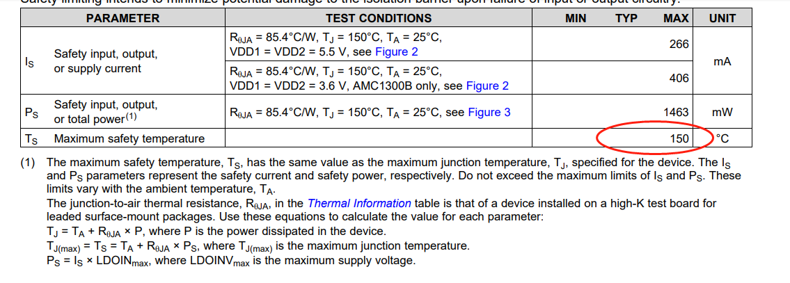

    Section 7.5 Power Ratings shows the power dissipation in both datasheets.

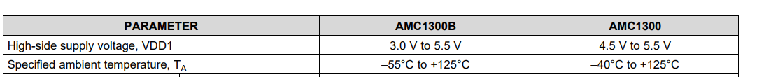

    AMC1300x:
    AMC1311x:
