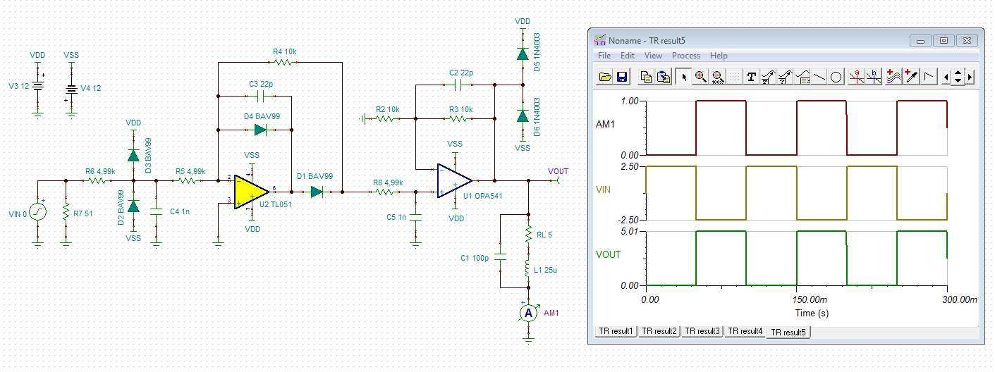

Attached find Altium 18.1.9 design files and dwg schematic in case you cannot read it.
Kindly have a look at them and see if it makes sense for a simple four layer board similar to Figure 13 of the datasheet for a 25 uH 5 ohm Helmholtz coil pair requiring a .9 A peak current.
Of particular interest are the placement of R4 / current sense resistor and D1 and D2 diodes and output feedback connection location.
