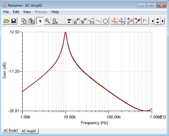

Hi Shibuya,
with the UAF42E model (instead of UAF42 model) your simulation works for me:
Kai

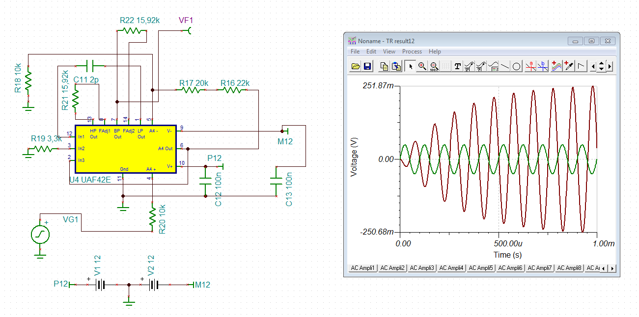

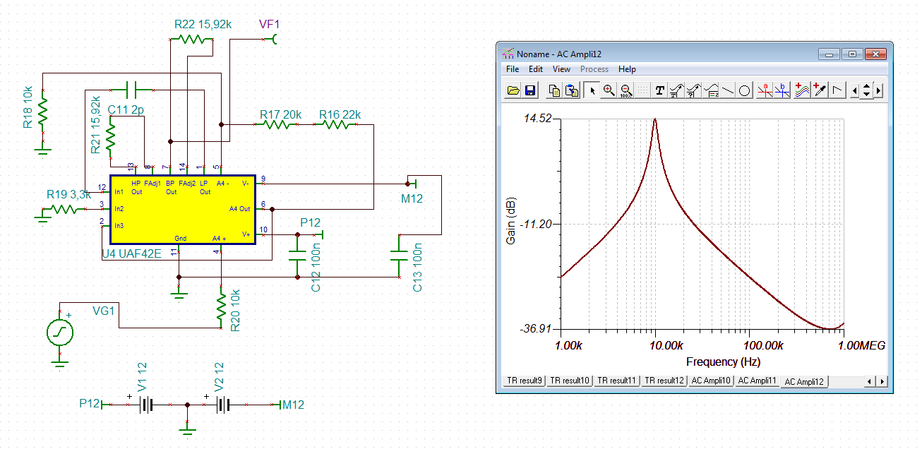

Hi kai sir,
I have also tried the UAF42E model with shibuya's simulation but couldn't got the same response as yours. The file is attached here. Can you tell me where i am going wrong. Also i have confusion in selecting band pass cut frequencies. How can i adjust the frequency band in this circuit as there is no particular example is given in data sheet.
Hi Parag,
The UAF42 works like any other state-variable filter when it comes to setting the frequency and Q.
Have you read the appnotes?
Kai
